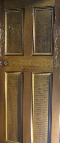

Restored old door in my sisters Air BNB house door was painted in wood grain paint had of scratches I paint stripped it all including hinges and for handle sanded back roughly to give it the petina look then rubbed bees wax on door sanded door lock painted it cleaned all brass fittings put back to geather

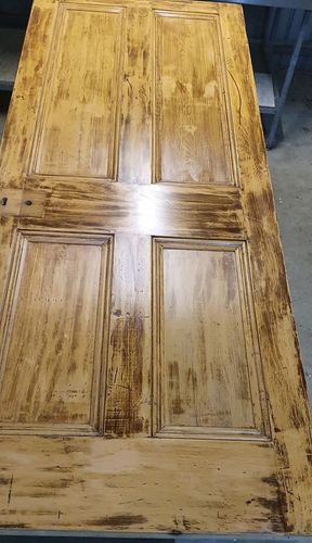

Add paint stripper to door one section at a time then scrape
Step 3
Once all stripped sand with fine paper
Step 4
Rub in bees wax to give it shine and protection

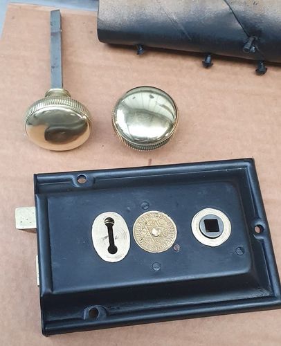

Clean all handle take apart grease all internal parts sand old paint of clean brass with brasso making sure to get all green stain of put back togeather

Finally put door back together sit back and admire your handy work have a beer then re-hang door
