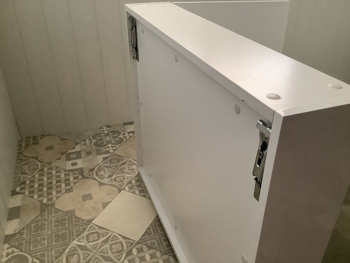

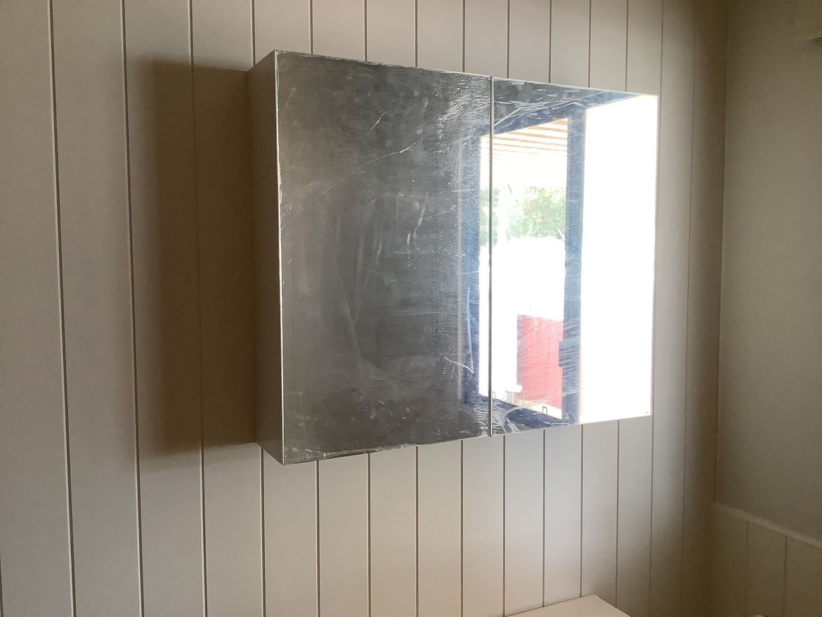

The hooks attached to the back of the cabinet do not extend out far enough to be able to hook onto the wall brackets. The cabinet has an edge around it which protrudes further than the hooks. How do you adjust the hooks attached to the back of the cabinet? The wall hooks are positioned properly and I have the installation instructions. We have actually just sorted this problem out but needed help to release the top screw on the inside of the cabinet that was so tight we could not budge it. Maybe this is a common problem that could be addressed so other people do not have this issue.

Thank you for getting back to me. It might be helpful to future buyers of this product if it is explained on the installation instructions that the top screw on the inside of the cabinet will extend the hooks. It would definitely have been helpful to me. Once again thank you for your time.😊
