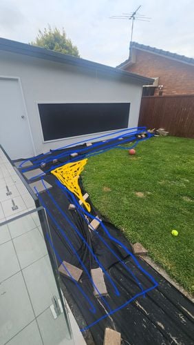

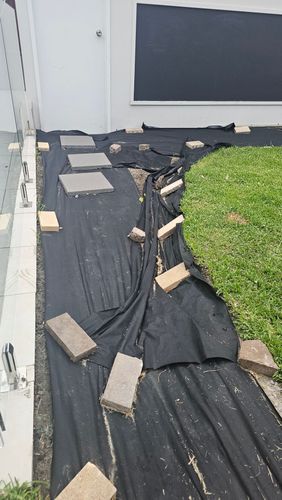

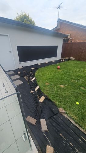

I’m looking for advice on a low-cost, temporary solution for this drainage trench I’ve dug to prevent flooding in our garage/storage area.
For context: we bought the house last year and discovered significant drainage issues caused by poorly planned site works and vegetation clearing that were done purely for cosmetic purposes before the sale. The pool itself isn’t the issue, but the site works have resulted in water flooding our garage (a converted shed). The slab of the garage is about 150mm lower than the pool and surrounding ground, and the garage was finished with external plasterboard walls, just to give you an idea of how dodgy the conversion is.
The trench is a solution to stop water pooling and flooding. It’s quite deep, as it needs to carry most of the water from the site, including roof runoff that discharges directly to the ground due to the age of the house. Its far from ideal but its working. At the moment, it’s lined with mid-range weed mat from Bunnings to stop it becoming a mud pit for our two active dogs. The trench cuts across the path to our house and runs through the main yard where everyone plays, making it an eyesore and a hazard.

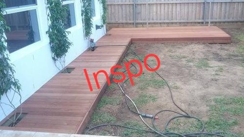

Here’s my idea (inspired by the last photo I’ve included):
1. Fill the trench with drainage gravel to create a level surface while still allowing water to flow and drain effectively.

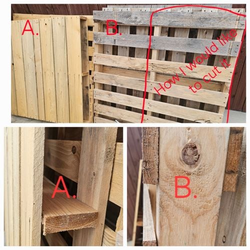

2. Use pallets (coated with paint bitumen underneath for slightly more longevity) to create the base of a floating boardwalk.
3. Lay decking timber across the pallets (running longways for ease) to tie them together and create a stable, usable surface.
From what I’ve learnt from here and YouTube, this might just work if I can get the details right. Keeping in mind I only need it to last 2 years.
I’ve attached photos of the trench and the two types of pallets I have access to (labelled A and B).
I don’t know whether these are hardwood or pine – can anyone tell from the photos?
Which style (A or B) would be better for this project?
I’m considering cutting the pallets back to the centre support (as marked in the photo of pallet B) to make the path narrower and reduce decking timber costs. Is this viable, or would it compromise the stability of the structure?

Part of the boardwalk will be over the 'embankment' where the soil now slopes significantly away from the pool and garage to carry away water, will 'leveling' with gravel maintain the underlying slope?

Any suggestions for how to finish the curved area in the corner of the trench? I’m undecided on the best approach here.
I’m aware of the need to be careful near the pool fence to avoid altering the ground height and impacting compliance with safety regulations.
