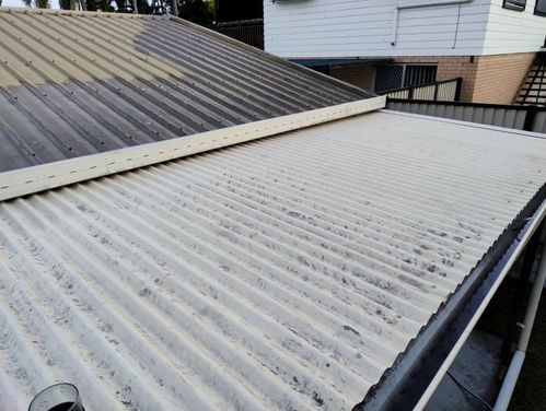

hi I’m wondering if you can dilute Domestos to clean a colour bond roof

It's best not to use Domestos on a Colorbond roof. Domestos contains bleach, which can damage the finish on the roof, leading to discoloration or degradation of the protective coating over time. Even in a diluted state the bleach is still quite strong. Instead, it’s a safer option to use roof-specific cleaning products, such as 30 Seconds Roof Treatment, which is available at the store. This product is designed to be gentle on Colorbond while effectively removing dirt, grime, and algae. Always follow the manufacturer’s care guidelines for your roof and test any product in a small area before proceeding.
