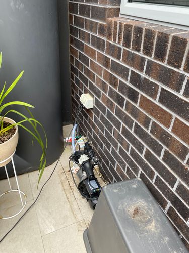

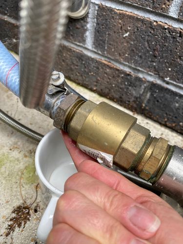

Hello there, I have a leaking pump which is connected to my water tank outside as per the photos. How do I fix it? Thank you 😊

It's possible that the thread seal of the threaded brass parts have deteriorated due to the constant vibration of the water pump. Generally speaking, the brass parts would be taken apart and new sealing tape would be applied to the brass threads and then it would be re-installed. However, the pump must be reprimed properly and any air trapped in the system must be purged before the pump is turned on.Â
Because it is quite involved, I suggest engaging the services of a licensed plumber to fix your leaking pump. The repair will be done to code and will be covered under the plumber's warranty.Â
