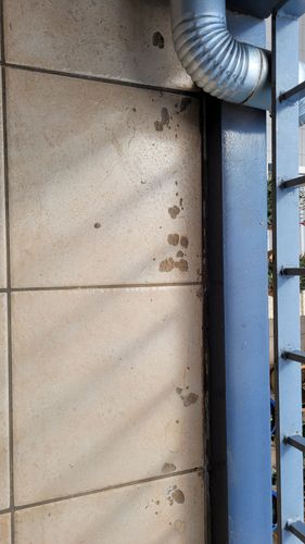

Hello. The tiles on my balcony have been chipped off, and I would like to seek advice on how to fix them temporarily. I saw an old post mentioning epoxy putty. Would it work for my balcony? Please see attached photo. Thank you.

You are correct, we do sometimes recommend using Selleys 50g Knead It Multi Purpose Epoxy Putty to patch tiles. In this particular situation, I also suggest getting some paint that is close to the tiles colour. Once the epoxy cures you can paint over the surface so that the patch will blend into the tile. My best advice is to make sure that the surface is very clean free of dust and debris. Fill only to the surface of the tile so that you won't have to do a lot of sanding and make sure that the putty is totally cured before you start painting.
Thank you very much Eric for your helpful & quick response. Should I also apply some waterproofing sealer given the area is outdoor?

No need to waterproof the putty, but you will need to touch up the paint every now and then when it starts to fade away.
