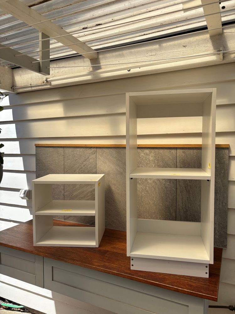

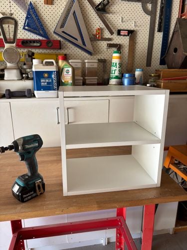

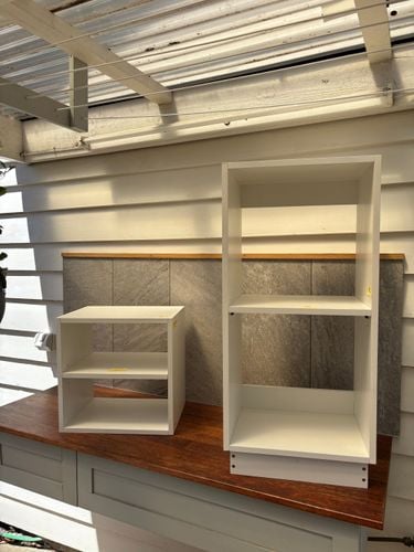

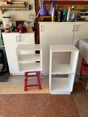

I had some white melamine board left over from another project, my grandson asked if I could make him a bookshelf for his place, I ended up making two units.

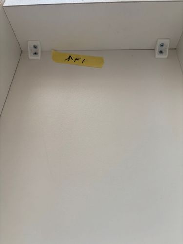

Plastic brackets and screws for kick rail.

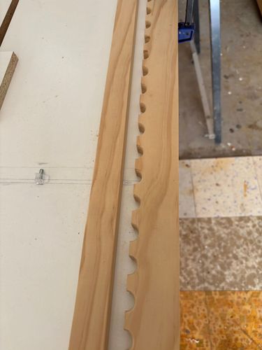

Router and 5mm router bit for shelf pins
Home made shelf pin jig.

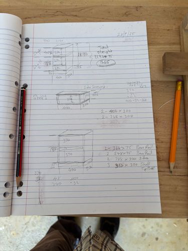

Draw up shelving and a cutting list

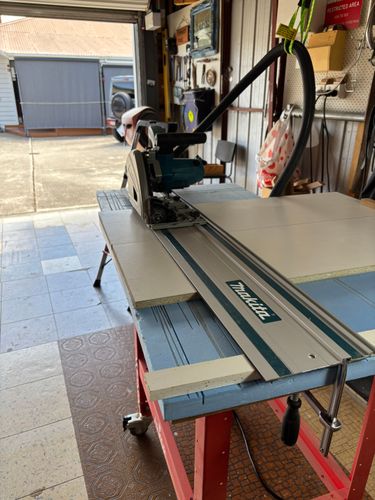

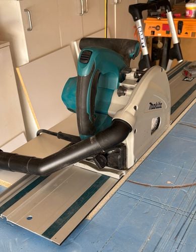

Cut material to size using track saw, using the track saw has saved me a lot of work where previously I had cut the board with a power saw a couple of millimeters oversized, then trim with a router to remove the chipped edge caused by the power saw, the track saw gives me a perfect finish, by doing a scoring cut then a second finish cut.

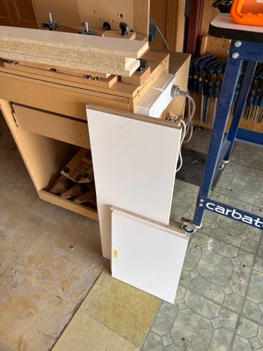

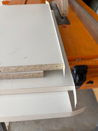

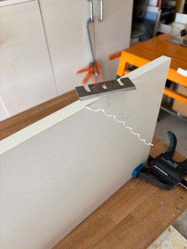

Once all the material has been cut to size, I fitted all the melamine edging, using a hot air gun and a cork block to press into place, when it has cooled down, I trimmed off the edges using an electric planer blade, the sanded the sides to a smooth finish, I also filed the ends of each board.

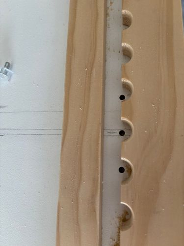

When all edges were done, I routered the pin shelf holes using my diy pin shelf jig.

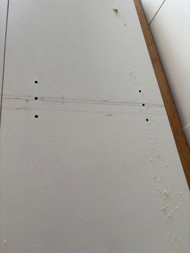

I pre drilled the screw holes on each board for assembly
Step 6

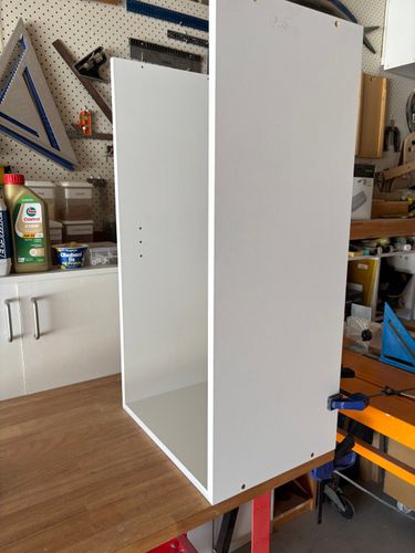

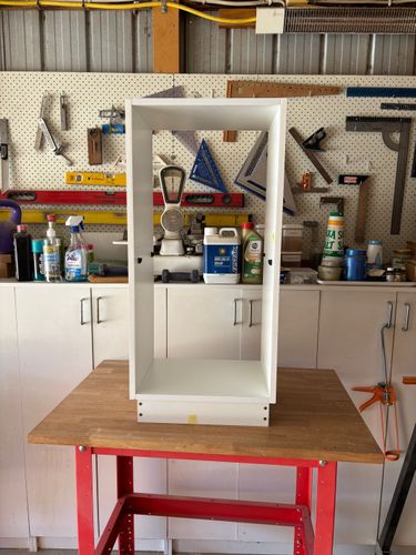

Install kick rail to larger shelf, I also found that the book shelves didn’t need and backing board, it was sturdy on its own.
All done 😀
