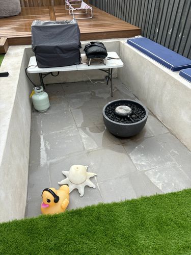

Hi team, I am building an outdoor box seat with storage. It will be down in a sunken firepit (which has drainage) however my question is about material.
I was thinking of building a base with marine ply and facing it with aluminum and marine ply built seat faced with external cladding. Is this the best way to stop any water getting to the ply ?

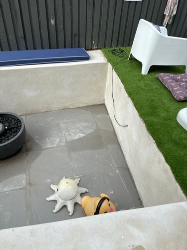

Pictures is of area it’s going so it will have rain contact.
Also is thick marine ply enough or should I use treated pine for a frame first ?A Bunnings video I watched just uses mdf however that was inside but no pine frame as of such.
