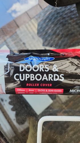

Now about painting the panels, are these rollers suitable for painting the
panels?
Morning @sud
The pic made me smile, I was looking for how fluffy it was hahahah You have all the info there bar the fluffyness 🙂 It looks like it will be fine, the fluffness will help paint within the VJ gullys is all. 🙂
Typically, you would use a higher nap roller, somewhere in the 10-15mm range, however you can get the job done just fine with these rollers, it may just take a little extra time because they won't hold as much paint.
If you want to use the one you have there are no issues, but these UNi-PRO 230mm 10mm Nap Microfibre Paint Roller Covers would be ideal.

When using the Dulux Wash & Wear, the rollers I have mentioned are perfect.
