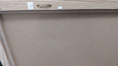

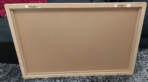

I want to hang this frame up, it's got 2 sawtooth hangers at the back and I'm not sure what screws/anchors I need to hang it up. It weighs 2.78kg.

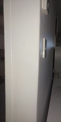

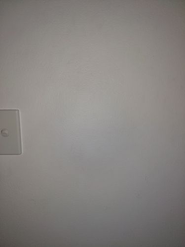

Sorry just a question, how can I tell what type of wall it is? The wall feels quite strong like it can't be easily wrecked but I've seen a wall switch being installed once in another room and the inside of the wall was only about 10cm thick and then everything else was hollow like there was no brick etc. Not sure if it'll be any help but I'll attach a photo of the wall.
If it is a hollow plasterboard wall you can use the Ramset 6 x 38mm Universal Anchor - 6 Pack. But as I mentioned, if the head of the screw is too big for the saw tooth hook, I suggest using the Everhang 20kg Heavy Duty Solid Wall Picture Hanging Hooks in combination with the screws. If you need further assistance, please let us know.
