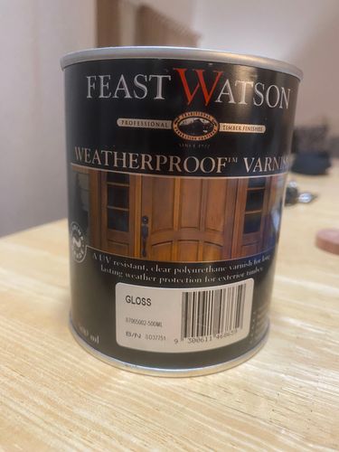

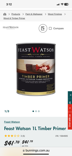

Hello Eric
Could You please tell me if this varnish is compatible with the primer above as I have bought this and I’m not sure whether it is water based as recommended.
thank you for your help.
Yvonne
I've just been in contact with the Feast Watson technical team, and the Feast Watson 1L Gloss Clear Weatherproof Timber Varnish is compatible with the Feast Watson 1L Timber Primer. Both products are oil-based so they will work together. My best advice to is to make sure to give the primer enough time to cure before you put the varnish on top.
