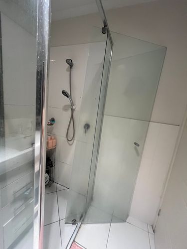

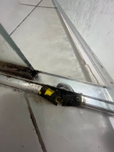

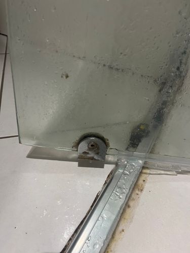

My glass shower door is broken as the picture. The bottom parts were old.
Im a single mother and I don’t know how can I fix… Can I buy some parts from bunnings?

It appears that the pivot hinge of your shower door has failed. The only way to repair it is to replace the hinges. The hinges to the showers at the store are custom fit to those showers only. If you know the make and model of your shower you might be able to get a spare from the manufacturer. But if not, I suggest engaging the services of a professional shower installer. They will have the knowledge and experience to fix your shower door.
Please note that working or moving the shower door is dangerous. An accidental hit with a tool or a strong hit to the corner could cause the glass to shatter and cause injury. Please be careful and make sure to wear gloves and goggles when moving or working around the glass panel.
