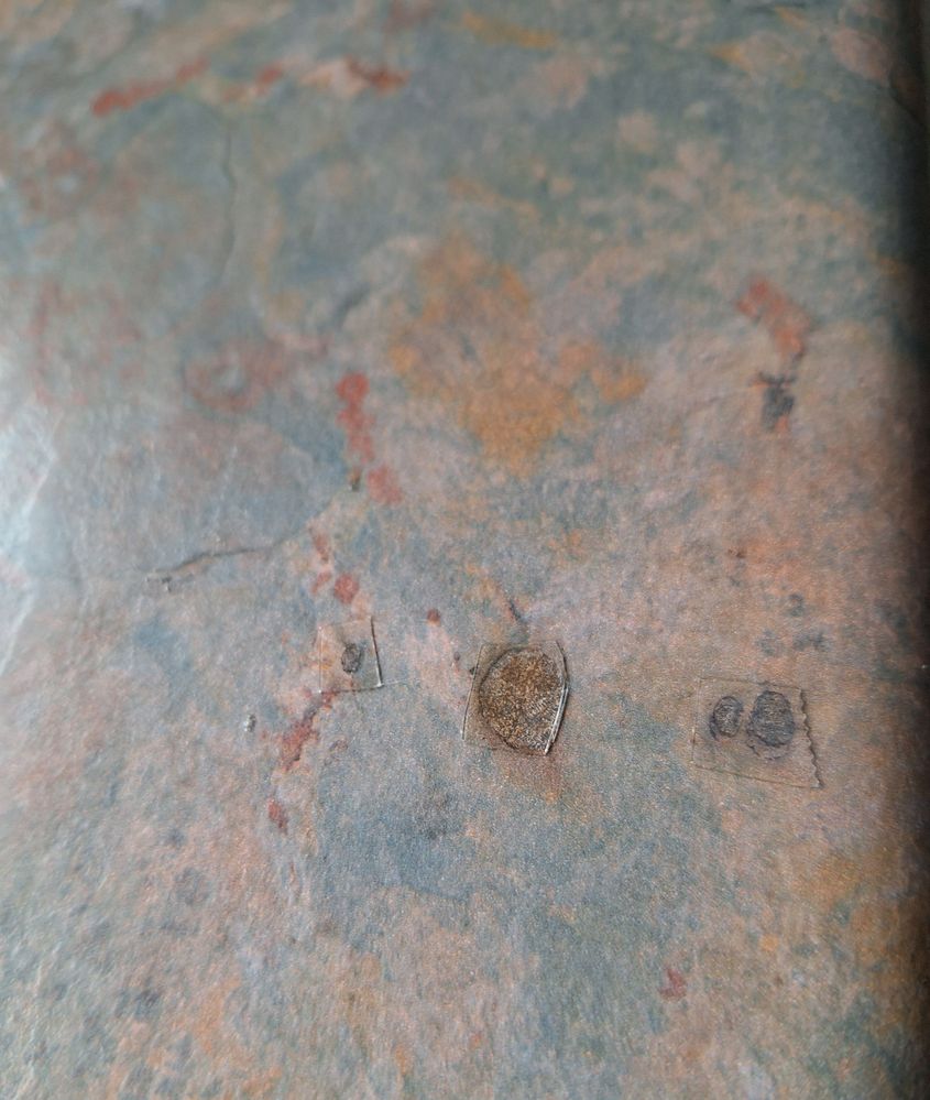

Hello,
Can you please tell me what I could do to fix these? They are chips that have come off kitchen bench. Looks like it is marble kitchen bench but not sure. Have put tape over them and coloured them in for now.
Oh dear. Maybe take better care of it.. don’t think it’s marble, looks like laminate. IKEA sells fabulous products for hot kitchen pans/fryoans…trivets. Please invest in some so this doesn’t happen.
Hi @gardenia8888,
Thank you for your question.
The solution is to use a multipurpose filler to fill and smooth the surface, give the filler a light sand and then paint it with a suitably coloured paint to match the benchtop. If the surface is marble, make sure you are only sanding the filler as you won't want to sand the stone. It is worthwhile wearing a mask while sanding to protect yourself.
To select your paint, I would suggest heading in-store and grabbing a few colour cards that look close to your benchtop. Take them home and compare them to the benchtop to select the closest match. Once you've selected your colours, head back in-store and have the team at the Paint Desk mix you up some sample pots of paint.
Some craft brushes will come in handy to give fine detail to the paint repair. Aim to match the colour distribution in a similar way to the benchtop.
Let me know what you think.

Hi Jacob,
Sending you a photo of the edge of the kitchen bench. Tried to take a photo of the underside but it was a little hard. It sounds hollow when I tapped my fingers on the surface. Thank you very much for your help.
Hello @gardenia8888
Thank you for sharing those extra photos of your benchtop. Based on the patch located in the corner of your benchtop, it appears to be a laminate benchtop. Laminate panels typically have a brown timber edging when viewed from the side, which helps identify them. This edging is often a sign that the benchtop is constructed with a particleboard or MDF core, covered with a thin laminate surface for durability and aesthetics.

Thanks for your reply and for confirming it is laminate. I can now make the right decision on how to repair the surface chips.

A fine-grade paper such as 240-grit would be suitable for sanding any filler @gardenia8888. I'd suggest you tape up the surrounding area so you don't scratch it in the sanding process.
