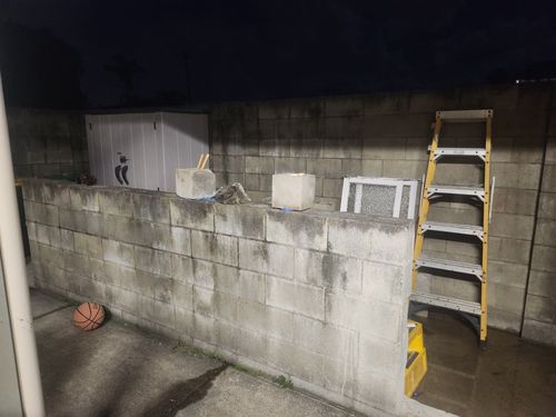

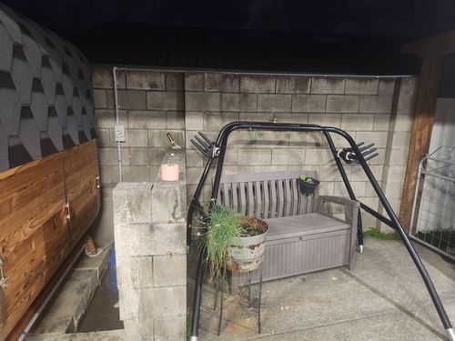

I was wondering how the water was making the blocks look like long term dampness. The photos show water in a pond? and also another section that looks like a long rectanglular water area? Does the water wick up the bessa blocks?

Looking at the photos you posted it appears that you have heavy moisture coming out of your Besser block wall. If this so, it means that any paint you place over the wall will peel off because of hydrostatic pressure. The moisture ingress must be addressed first in order for you to paint the wall properly. The general repair steps will be to gain access to the other side of the wall and clean it off with a pressure washer. Once the wall is clean and has dried off a waterproofing membrane such as Gripset Betta 1L Waterproofing Membrane Bitumen Rubber needs to be applied.
Give the wall several days to dry off just to make sure that there are no other points of entry for water to get in. This would also be a good time to address the water coming in under the Besser block wall. Once all the leaks have been addressed the wall can then be painted with an exterior paint such as Dulux Weathersheild or Taubmans Sunproof.
