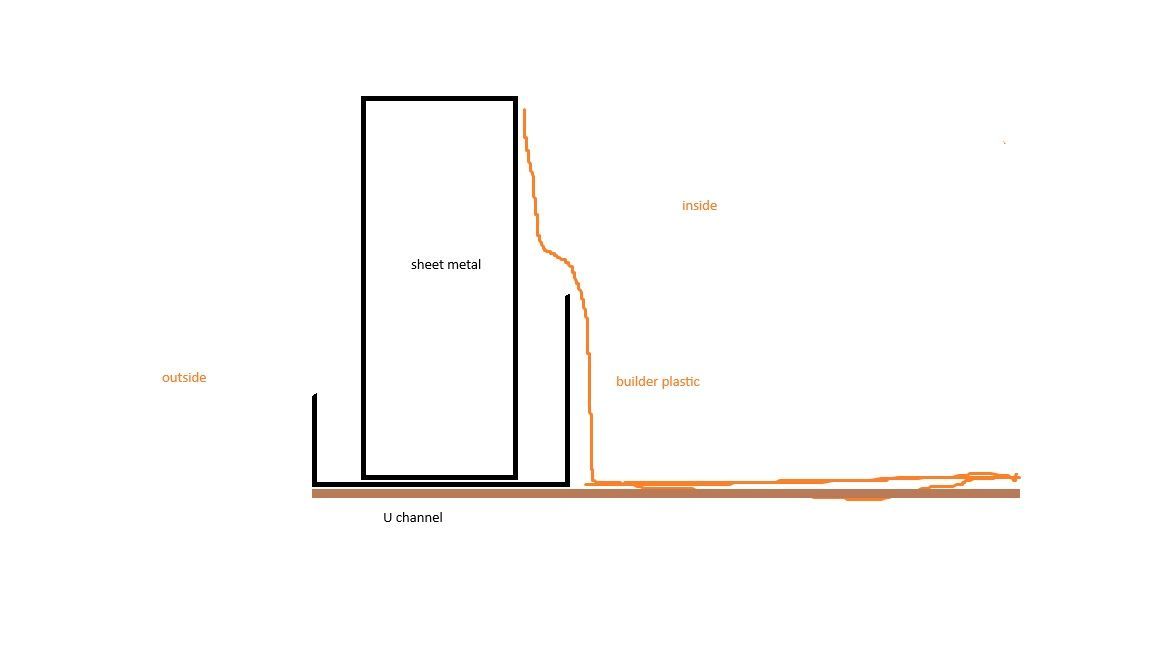

I have read through the post about waterproofing your shed. My shed is not built yet but my slab ready - but its not rebated.
I read about the U channels at the bottom of the shed.
My ideas are to use builder plastic inside the shed - see diagram to protect damp rising from the slab that had weep in from the side. (I am not sure if plastic sheet was below slab).
also to use plastic pallets as raised floors. i probably have to cut it down given shed is only ~ 800m wide.
Can anyone point out any issues with this plan?
Not sure about the sliding door bit yet.
thanks!
