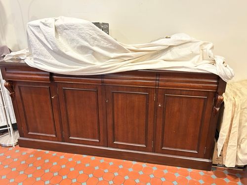

I need to make it a much lighter cream colour to match new kitchen
Hi @gem717,
You'll have to start by removing the varnish from the surface of the cabinet. You can either sand it all off or use a combination of Tricleanium Paint Stripper and sanding to remove the varnish. If you plan to use a chemical stripper, make sure you do it in a well-ventilated area and wear gloves, protective clothing and a mask.
Once the varnish has been removed, you can paint the cabinet in a colour of your choosing. The range from Porter's Paints would look fantastic.
Another option is to limewash your cabinets. You can check out @prettyliving's guide on How to lime wash timber furniture for some easy-to-follow, step-by-step information on the process.
