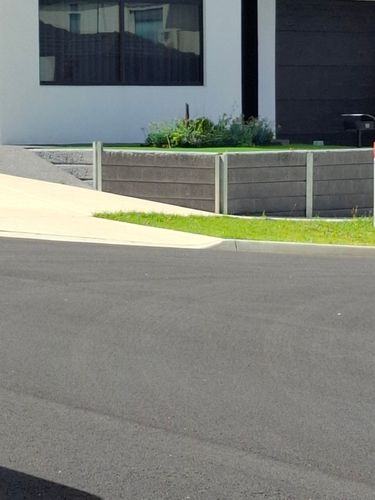

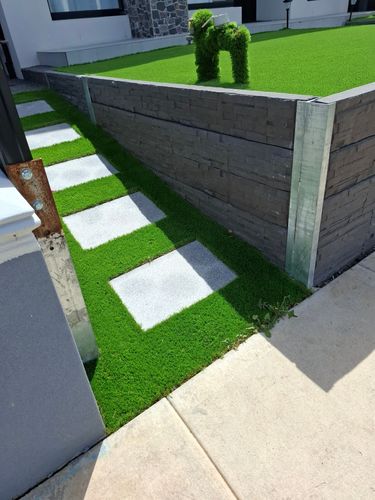

I'm looking to build a brick garden bed on a slope, do you dig the slope until it's flat or do you cut the brick?
I know the photos are for concrete sleepers but this is just to explain my idea.
Thanks in advance

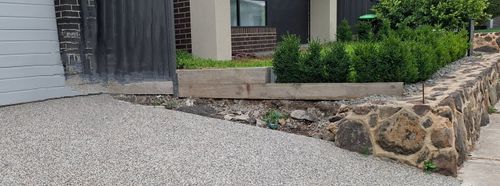

Hi @Jewelleryrescue , thanks so much for the response. I like the idea of the footsteps as the slope I've is nearly 1 meter and it has lots of rocks, it's like an inverse triangle as per attached photo, so I need to build a garden bed as an extension to the rock retaining wall. I was thinking to use this brick https://www.bunnings.com.au/adbri-masonry-300-x-160-x-100mm-bluestone-natural-impressions-block_p3041942, but I'm also open to suggestions.

Might i say i would take out the first half of the wooden plimth (cut it in half) under the first section of the fence and extend your new wall under the fence. Why just to give the illusion the retaining wall runs further up your property and gives a more uniform look the that side of your house,
You may need to cut your blocks to size to fit you custom area. So use an angle grinder with a Cheap diamond blade as you only have a few cuts to do. Cut the blocks all the way around 4 sides (as the diamond blade won't cut all the way and then tap the offcut it will fall off cleanly. Rest the good block half on a solid surface with a square egde on the cut line is on the overhang for the off cut to fall with a hammer tap.)
Thanks so much @Jewelleryrescue , is there's another way of doing this without having to touch the wooden plinth, my neighbor is not the easiest person to deal with, so if there's something I can do to make it visually looking good without having to do these cuts, that would be appreciated.

I suppose the easier solution is to paint the pinith brown like the fence and if you zipped in there and painted it i doubt any one will have noticed too avoid a discussion with a difficult person .
Visually on there side of the fence it will look good too.
But it is there side of the fence so if it is left untouched then thats there eye sore not yours.
So I would just do your wall and leave my original extra suggestion in the rubbish bin 🙂 I dont want to create a rift between neighbours' over a splash of paint..
