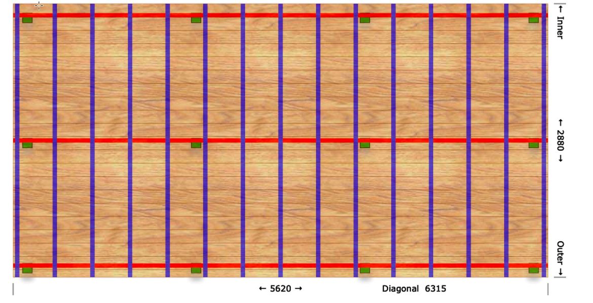

First time designing a deck and keen to get some feedback. Sketch is below.
In green, we have the posts, 100x100mm where the bearers will be set in also.
In Red Bearers – 190x45mm with 1318mm centres.
Joists in blue – 140x45mm with 395mm centres.
Deck it’s self will be 140x19mm Merbau with 4.5mm gaps.
A couple of questions, are there any issues running the Bearers as a single piece of timber? (5620mm)
And similar for the Merbau, any issues using 5700mm lengths cut to size?
The stumps will be 300mm above ground, noting the 190mm bearers will be set into the posts. So there will be 110mm from the bottom of the bearer to the ground, is this an issue? It will be 440mm from ground to bottom of the deck.
