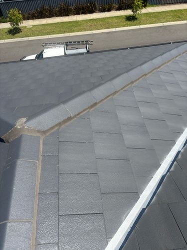

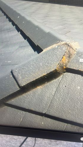

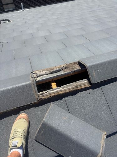

I recently got a roofer to replace my cracked tiles. In the process, they did an assessment of my roof and determined it requires a rebed. I have talked to 3 roofers and receive some different opinions. Photos below are provided by the second roofer.
can anyone please provide some insights on what I need get done? Thanks in advance.
