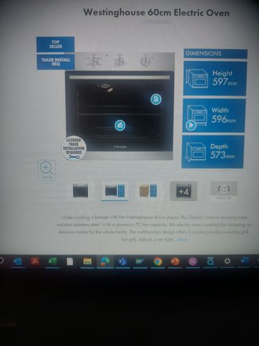

What built in ovens fit into the 600mm Kaboodle base cabinet. It's only 570mm wide so looking for options. I thought it would be a straightforward 60cm oven. Have I done something wrong with assembly?

The measurements you see about the Westinghouse 60cm Electric Oven WVE6314SD include the front panel of the oven. The installed section of the oven that fits inside the cabinet are actually smaller. If I have identified your oven correctly, the size it will need will be 565mm (w) x 590mm (h) x 560mm (d). The Kaboodle oven cabinet has an interior size of 568mm (w) x 688mm (h) x 560mm (d). From an installation point of view the oven will fit inside the oven cabinet.
If you wish to double check the measurements, you can download the user manual/factsheet on this link. The exterior measurements of the 600mm Kaboodle oven cabinet can be seen here. If you wish to calculate for the interior space of the cabinet the cabinet panels are 16mm thick.
Thank you Eric. That has helped tremendously !
