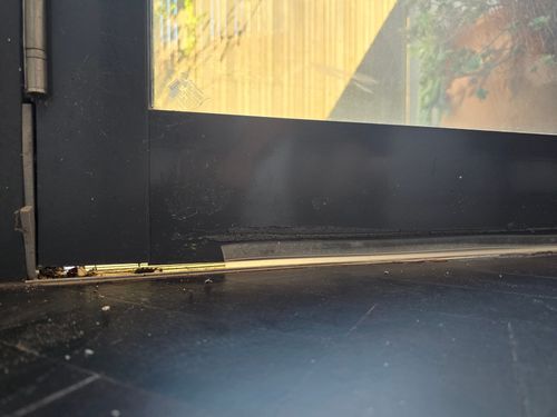

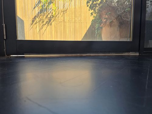

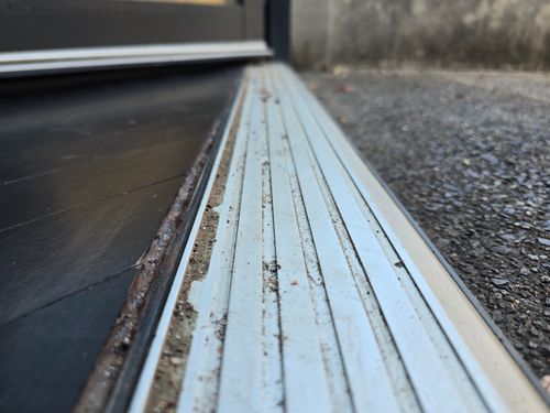

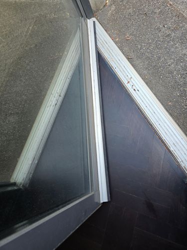

We were wondering what the best seal to stop rain water coming through our front door (predominately under the door)?
There's a small gap that's wider towards the hinge.
Thanks!

Hi Jacob. Thanks for the reply! Is this the door stop that's already currently installed:
It looks like it is.
Are you missing the small, angled block on the frame that makes it kick downward when the door is closed?
If so, then our Spare Parts team can help you out with ordering a replacement.
Yep, looks like I'm missing the cam that pushes it down. It also does look like it runs a bit short both sides.
I'll get in touch with spare parts, thanks!
