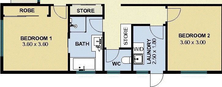

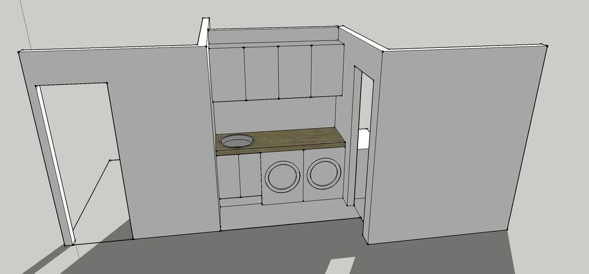

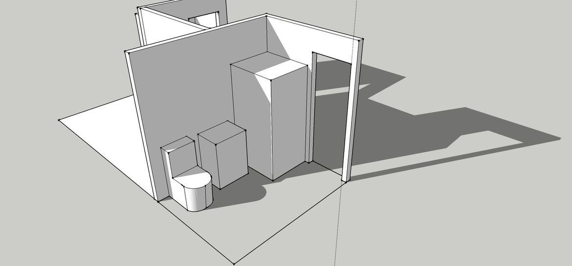

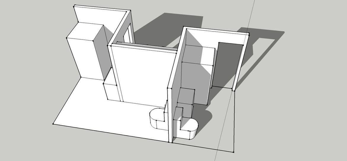

Currently our only bathroom and the only toilet are independent. We are thinking of updating this so that we have an ensuite (bathroom - includes toilet) and the main bathroom ( with toilet) separately by converting the laundry.

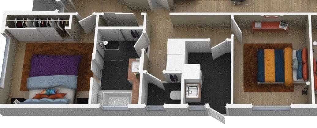

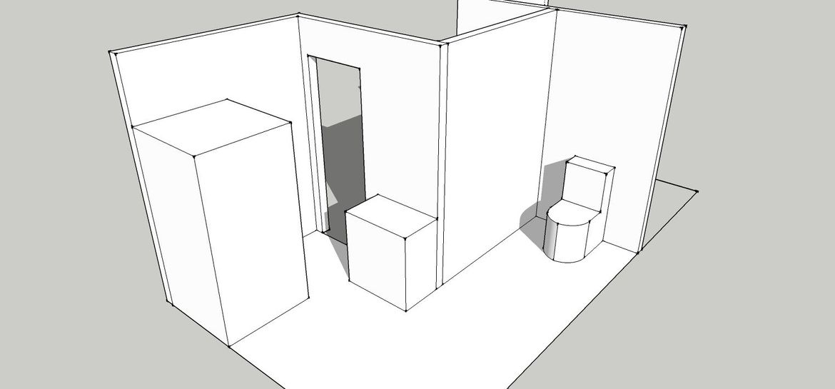

Please see the flow plan below. I have also included the measures of the existing areas.
State at present:

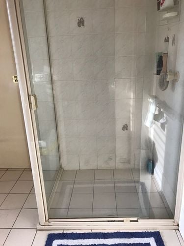

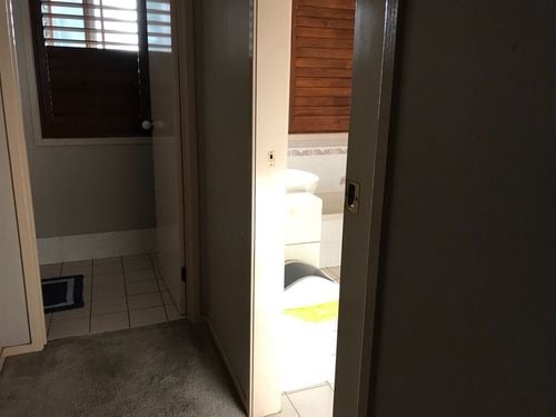

- Bathroom (2.9 x 1.7 ) has two sliding doors on either sides (one opening to the master bed room and the other to the passage way). There's a small bath, vanity and a shower cubicle. Next to the bath is a pretty big window (1.5 w x 1.3 h) with plantation shutters. Sonds a little complicated. please refer to pics.

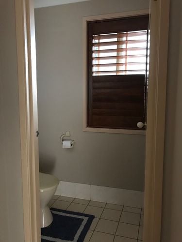

- Toilet (1.6 x 1.1) is just outside the bathroom, again with plantation shutters (0.8 w x 1.3h) and no wash basin.
- Laundry (2.5 x 1.8) is next to the toilet with a door to the outside and the normal entry via the shared passage way.
Since we just purchased the property we need to find the most optimum and affordable solution to make this project a reality. FYI the house is a single story house with a concerete floor.
Really appreciate your support in achieving this, may be in stages as our budget is pretty tight.
Our current thoughts are as follows: (please feel free to provide your feedback)
En-suite bathroom
- Remove the shower cubicle and move the shower to the bath
- Add the toilet to where the shower was
- Close the sliding door (passage side)
Extra bathroom/toilet
- Close the passage entrance from the living area and move it further down. This way the new passage entrance is in-front of the laundry entrance. This will be the entry point to the 2nd bedroom, the laundry and the extra toilet/bathroom.
