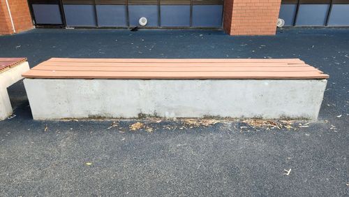

I've been roped into volunteering for the local primary school to do something about seating. They currently have concrete blocks with composite decking on top which has seen better days. Decision has been made to replace the composite with merbau.
That's fine, though the merbau should be sitting on top of joists for the usual reasons

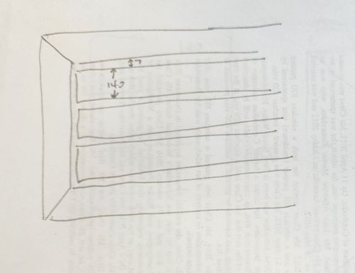

But - I can't really have the boards up from the concrete by much, otherwise the bench seating will end up being too high for the little ones.
Will raising them from the top of the concrete with 35mm treated pine be enough? If I do a vertical run of boards around the side to conceal these "bearers", am I going to be defeating the purpose of raising them that little amount in the first place?
