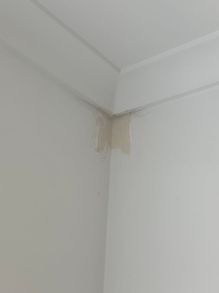

The cover plates were then installed and the wall was patched ahead of wallpapering.

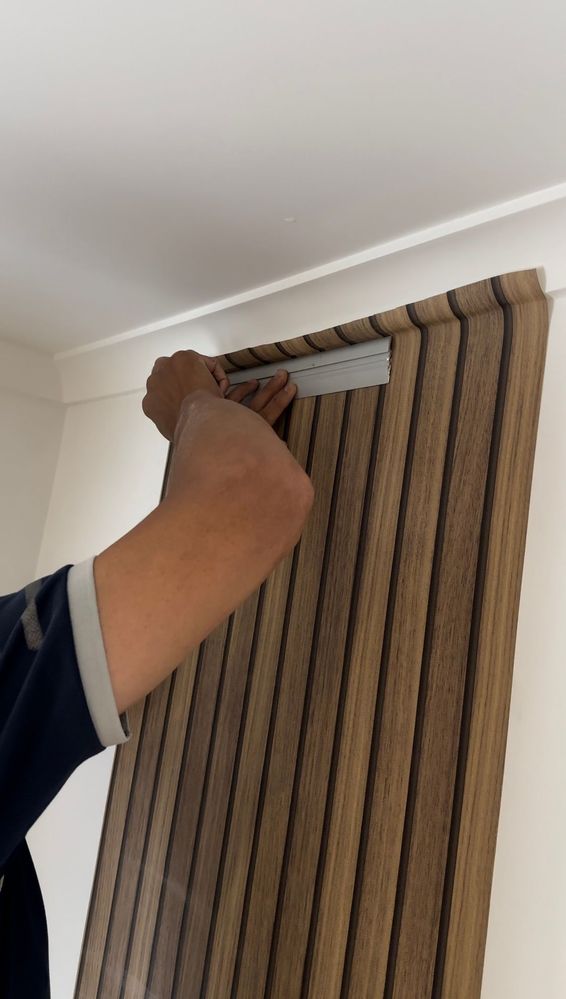

After establishing a level vertical line (which can be done with either a plumb bog or a spirit level), the first piece of wallpaper was hung. Usually, we assess the size of the wall and how many pieces we might need. For us, it made sense to start in the middle for our wallpaper project, but some people prefer to start at the wall edge.
The wall was pasted first. We carefully measured the length of the wall, and cut the first length of wallpaper, with extra to give a small overlap for trimming. The first piece of wallpaper was hung, with a damp microfibre cloth being used to smooth out any air bubbles or ripples, working from the top to the bottom. The cover plates were loosened, the wallpaper was cut around them, with a small overlap tucked behind them for a seamless finish.
Using a metal ruler, the top and bottom of the wallpaper were trimmed. Tip: do this before the paste dries or the wallpaper will stick to your cornicing / skirting boards!

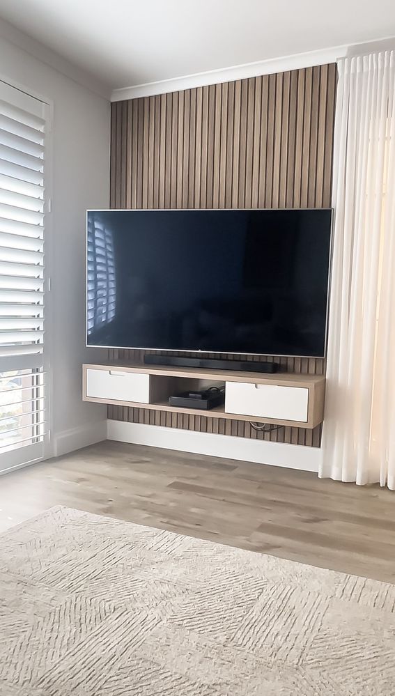

We fed all of the electrical wires through the hidden trunking first, as experience told us that this gets tricky if you have furniture and big TVs in the way.
Tip: If you aren't sure of which wire goes into what device, you can label them with a small piece of masking tape at one end.
The new wall-mounted TV unit was installed and the TV bracket re-attached to the wall and the feature wall was complete!
