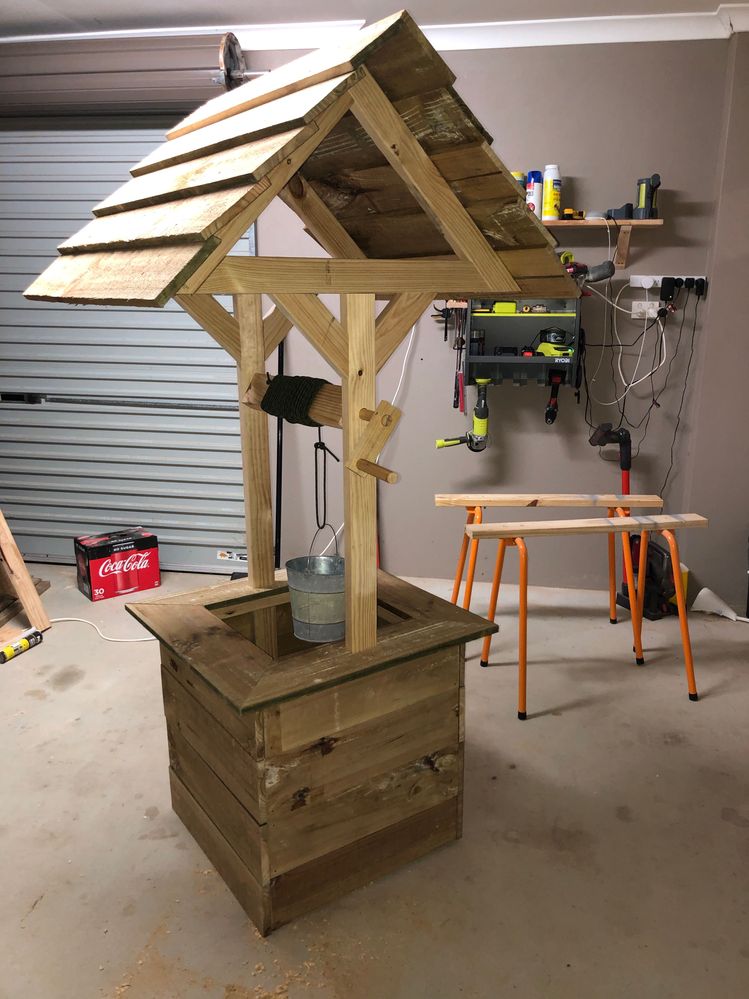

Hi Jason, I have made 3 of them now, the first was for my partner and when her friends saw it, they wanted one. I don't have any carpentry skills whatsoever, in fact, I was terrible at woodwork in school. I used a compound mitre saw to cut the timber and a join-a-jig to pre-drill the screw holes for any right-angle joins. The frame is made with 70 x 35 treated pine outdoor framing, the walls and roof are made with treated pine fence palings and the winch is made with a broom handle and timber off-cuts. You will be pleased to know that everything except the join-a-jig was purchased at Bunnings. I will be making another one next week and will post a picture of the frame.
