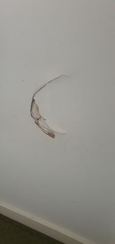

I've a hole in the bedroom wall that needs fixing. Planning to do it myself. Can you please advise what kind of plastering it would need? This is about 10inches.
Thanks in Advance

It's good that the damage is not so severe, I suggest using Pfeiffer 15cm Plaster Repair Wall Patch to repair the damage. The general steps are to clean the area first and remove any loose debris. You then place the wall patch over the damaged area, cover the surface with plaster and level it off. Allow the patch to cure before sanding then painting the surface.
Here is a handy step-by-step guide: How to patch a plaster wall.
