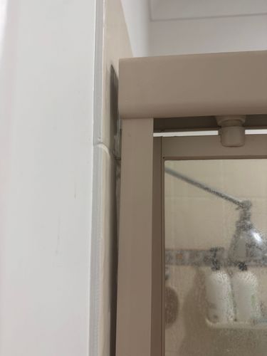

Hi Team,Â
My very old shower door has come out of the wall. I am inquiring how I go about fixing this d.i.y or will this be a professional repair?Â
Happy to provide more information if needed.Â
Thank you 🙂Â
Hello @chantelle1Â
Welcome to the Bunnings Workshop community. It's sensational to have you join us, and thanks for sharing your question about your shower.
In this particular situation, I suggest engaging the services of a professional to fix your shower. It will be necessary to take your shower apart so that they can get access to the mounting channel that is attached to your wall. Odds are the wall plugs used have deteriorated due to moisture damage, they then shrunk which caused the shower to come off the wall. Â
