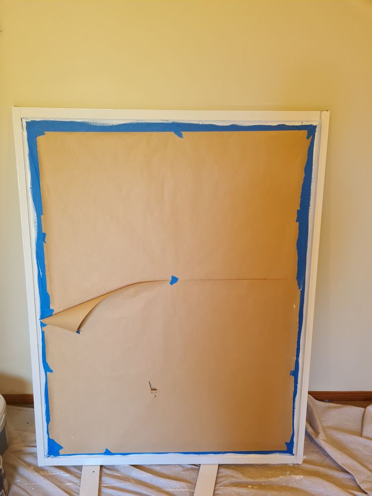

Painting the window: Clean window with soapy water and dry cloth. Use the painter's masking tape to tape the edges of the window. Use the primer to prime both sides of the window. Give two coats of enamel paint.

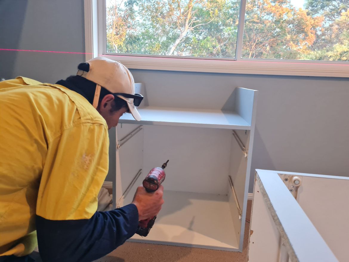

Preparing bottom cabinets: Lightly sand the bottom cabinets. Give each cabinet a coat of Renovation Range Primer. Give the cabinets two coats of paint (low sheen or satin). Add the brass knobs.
Step 4
Finishing: Paint walls with a low sheen paint (same colour as bottom cabinets). Put the bottom cabinets in place and screw them to the wall. Add a trim along the wall to hold the benchtop. Cut and place benchtop on top of bottom cabinets. Seal benchtops with Cabinet Makers Wax or chosen wood sealer.
