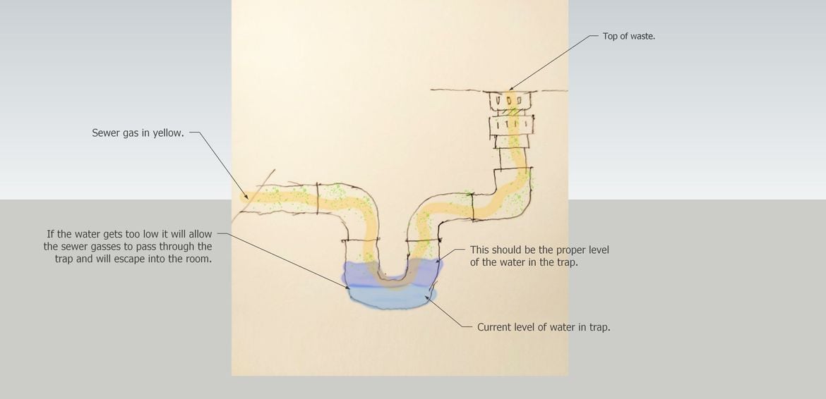

A water trap has been positioned somewhere in your plumbing layout to keep sewer gas from entering your home. If you've not been using your bath for a certain amount of time the water inside the trap might have evaporated to a lower level. If it goes past the trap point the sewer gas will be able to pass through the air gap in the trap and enter your room. Please have a look at the diagram below.
