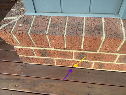

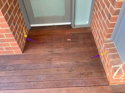

Hi. So I bought this house and the front deck has been built by the previous owner covering the weep holes (pointed out by the arrows), which is against the building code. Without getting rid of the whole deck, or lowering it all the way to the ground (to comply with the 75mm clearance) is there another solution? How much clearance does a weep hole need on its sides (it’s 100mm in front)? Any advice or any ideas would be appreciated! Cheers!
