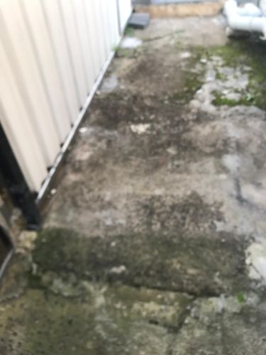

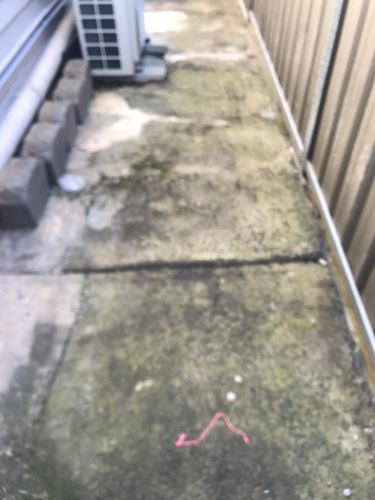

Sorry for the blur images. I am uploading new images,
The concrete is damaged and has develped lots of small and big cracks.
Thank you for your question about your concrete.
Unfortunately, I can't quite tell what the issue is as your images are quite blurry. If you could upload some clear images and let me know what the issue is, I am sure I can help out more succinctly.
A good place to start would be to give the concrete a good pressure clean. A pressure cleaner with a surface cleaning attachment like this Gerni 3600 1810PSI 1500W High Pressure Washer would make light work of the job. Check out How To Use A Pressure Washer for some guidance.
If there are other issues that need fixing, please let me know.
