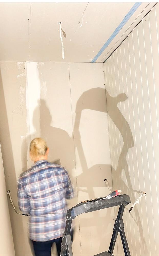

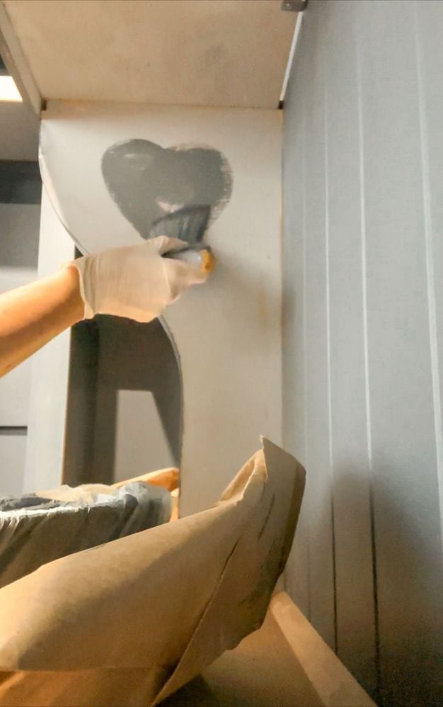

We used a VJ sheet on the back wall of the pantry and Gyprock on the ceiling and remaining walls. Once we had them installed we taped and plastered the Gyprock and filled the nail and screw holes.
Step 2

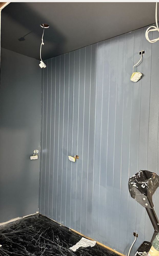

Once sanded, I colour-drenched the room using Dulux Wash & Wear in "Press agent".

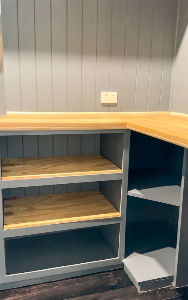

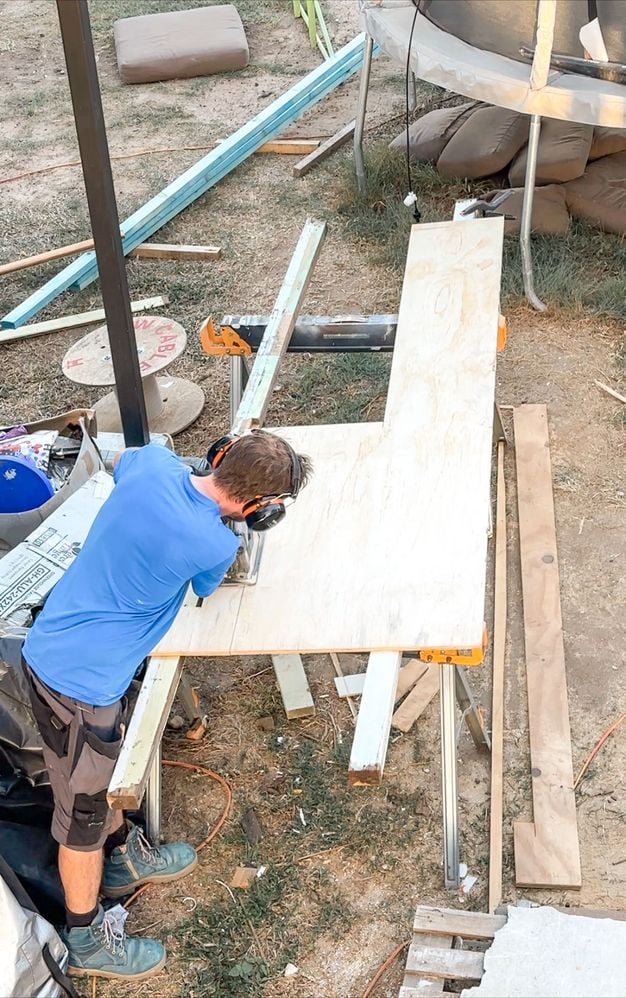

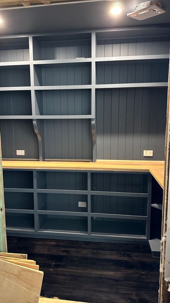

Derek and I built the pantry shelves and the base box out of plywood, we plan to add drawers as a phase two but the base shelves will work for now.
Step 4

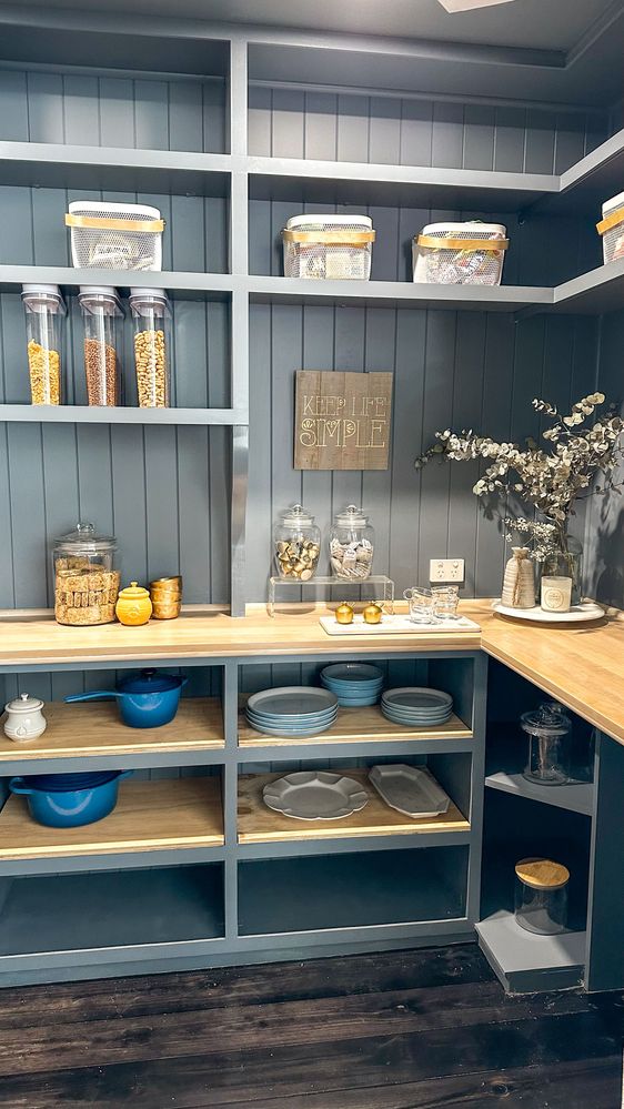

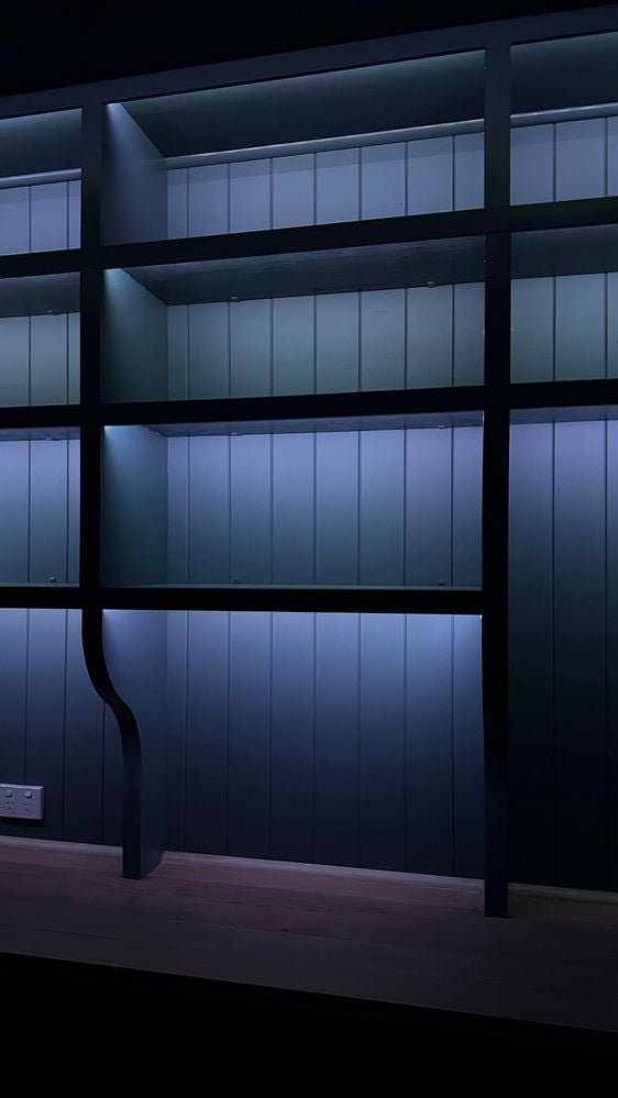

We added timber trim to the face of the shelves to strengthen the shelves and make the look more custom. We also added LED flexible tape lights behind the cornice and trim for ambient lighting.
As the air fryer and kettle will be in the pantry we added an extractor fan and LED recessed lights. We also found a commercial fridge on Marketplace.
Step 5

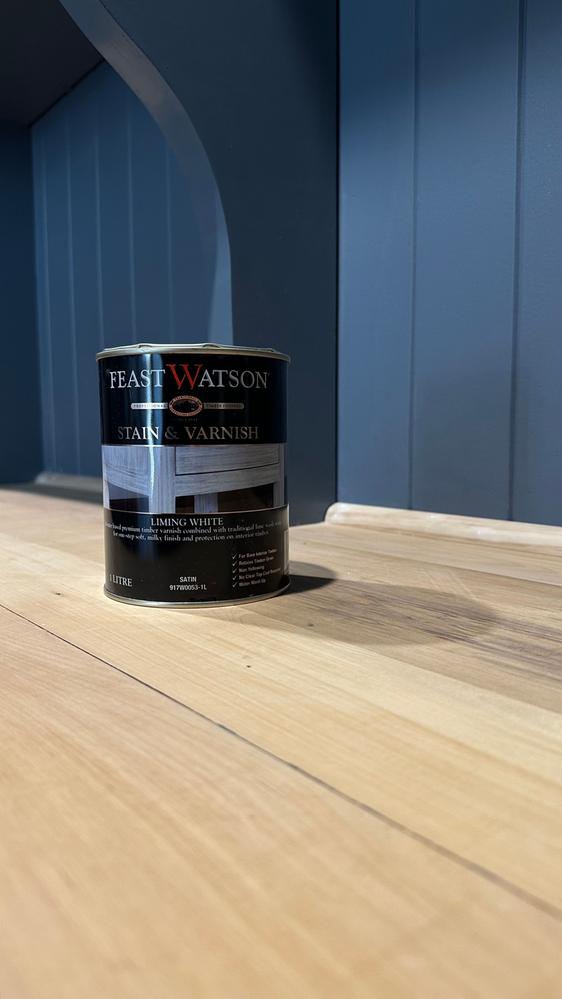

The counter top is made out of VJ panels that came out of our original kitchen. Derek planed and cut them down and we sanded and stained them using liming white stain and varnish.
