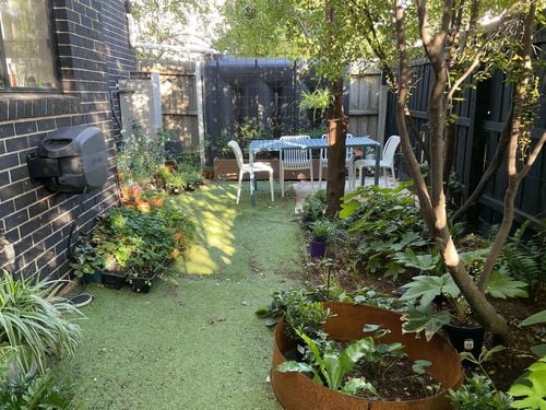

Our small courtyard currently has a pathway alongside the house that comprises astroturf on top of quite an uneven layer of crushed rock, which I think was originally compacted but is now crumbling at the edges and in particular areas. Underneath the astroturf and crushed rock layer is a layer of black plastic weed control mat, and beneath that is heavy (and also uneven) clay.
Here's a pic of it currently (with a bunch of pot plants / corten raised bed I haven't yet installed – ignore those for now!):

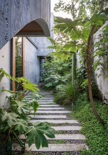

I'd like to replace this with a pathway made of staggered concrete sleepers as stepping stones, with gravel in between the sleepers, similar to this pic:
