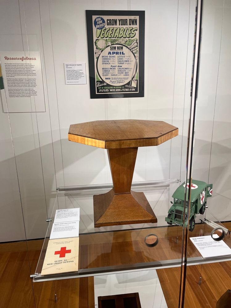

I obtained this 1940’s veneered octagonal side table from the local tip shop goodies junction. It was covered in blue paint stains on the table top and the veneer was split and lifting from the base. It is a Blyth 132 occasional table produced in the 1940’s in accordance with Furniture Standard No1.
I glued the split veneer back in place and clamped it. I restored the top with Oaks Restorer using 0000 steel wool. That step took three hours of work by hand.
Ultimately this piece will feature in an exhibition of my home front collection at the Canberra Museum and Gallery from August 2025 to February 2026 to mark the 80th anniversary of the end of World War 2
