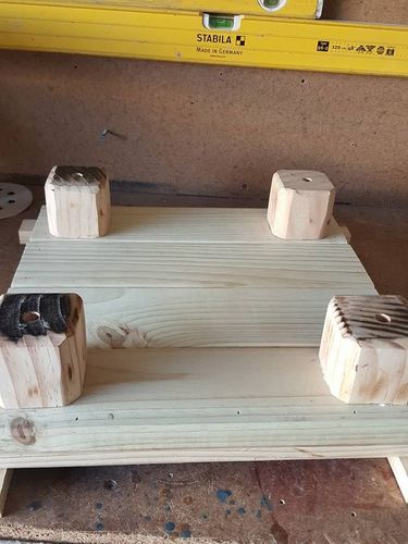

The base was built by nailing the 4 sides together. The first layer is to keep everything from falling out of the bottom. They were glued and nailed in place using a nail gun.
The legs were also glued and screwed into place in the 4 corners of the base.

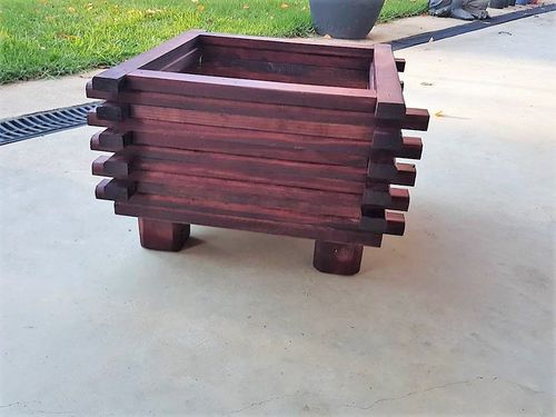

The wood was stained using dark mahogany wood stain. In hindsight, it would be easier to stain and varnish all the wood before putting it together. Two coats of outdoor varnish were added to protect the wood from the elements.
The inside was lined with heavy-duty plastic which was stapled to the sides.
