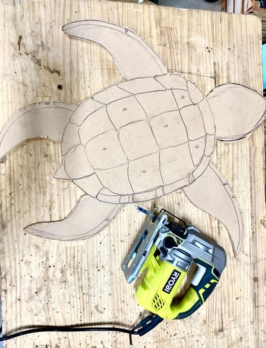

Draw and cut the stencil.

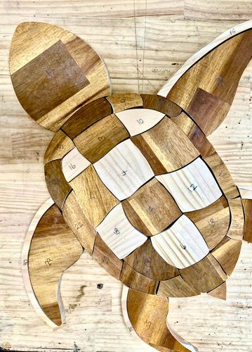

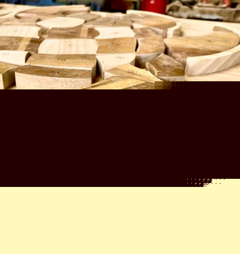

Use the stencil to mark and cut each individual piece, ensuring to sand each one before moving to the next step.
Step 3
Glue your pieces to a backing board (cut out in the shape of your animal). Once dry, sand thoroughly. Use the Dremel multitool to assist in sanding the joints.

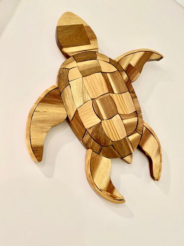

Apply two coats of varnish, sanding in between coats.
Step 5

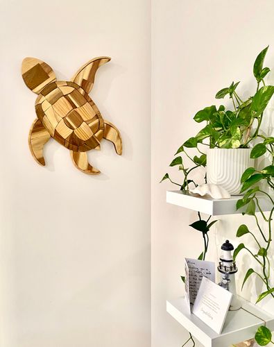

Pick your spot on the wall. Hang and enjoy!
