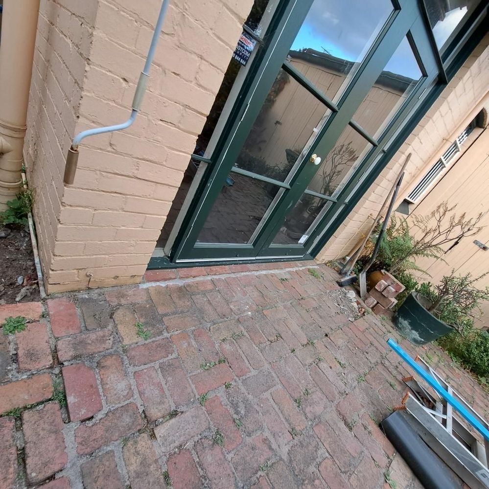

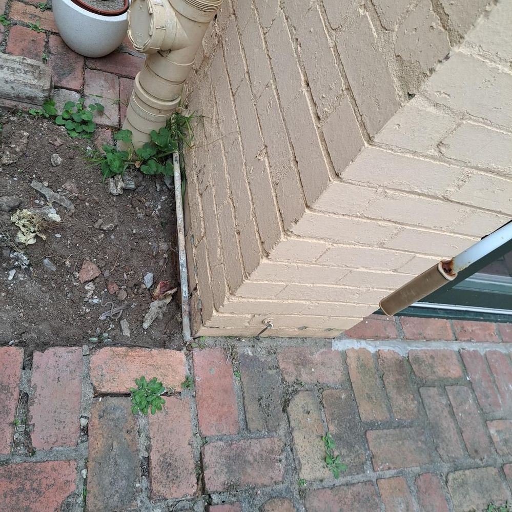

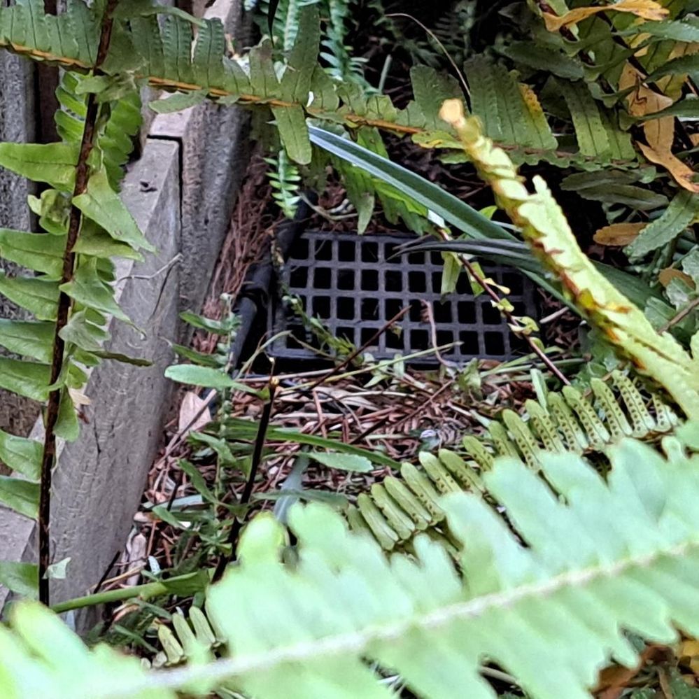

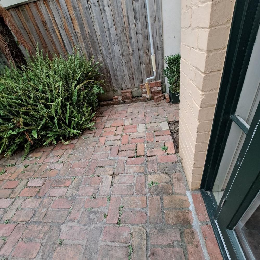

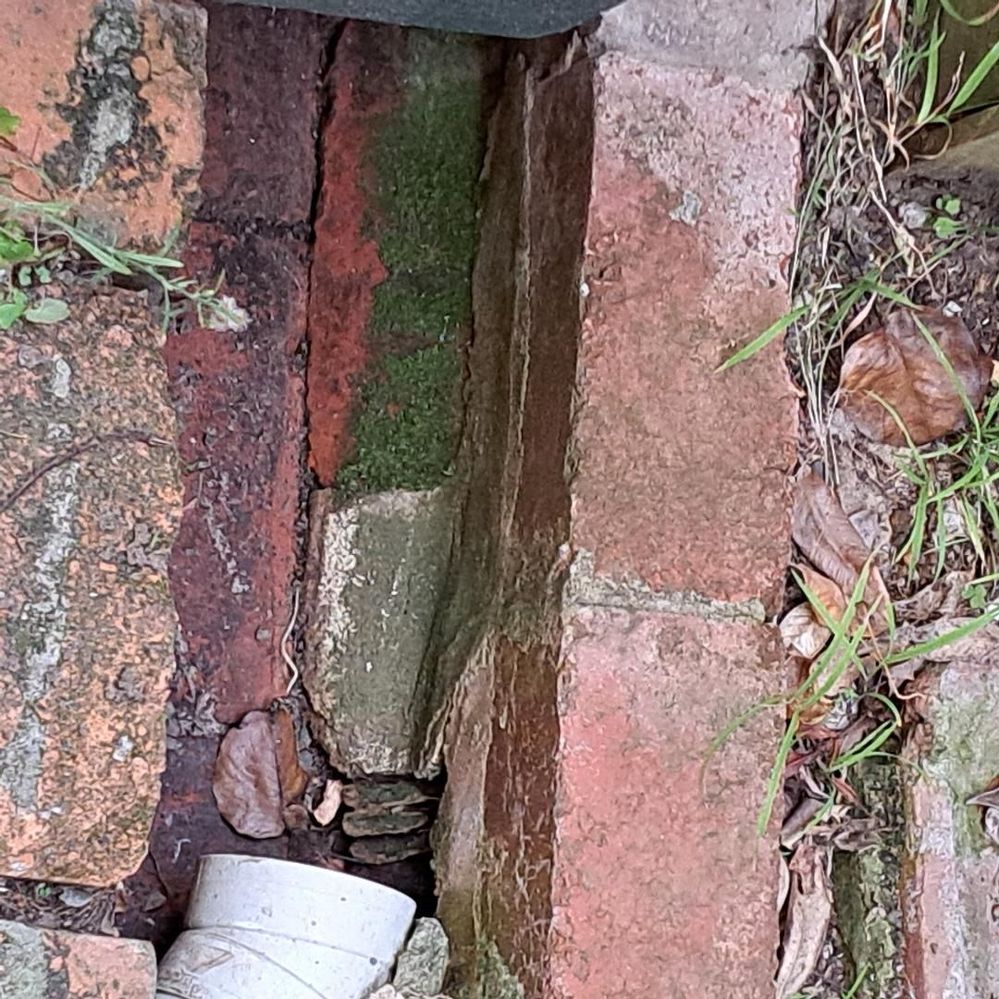

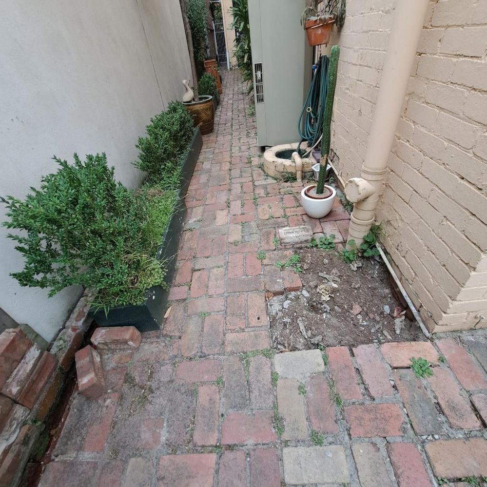

Hi there, so - I have a drainage issue at the back of the house. My late parents bought the house about 42 years ago and until 2 years ago we didn't have an issue. Then the floor boards got rotten from water damage. The back of the house and the brick backyard are against one another and it seems that water had seeped under the floor of the house and damaged a joist and the floor boards. I have builders doing fixes on the house - and they were going to lower the bricks but discovered they cannot due to the height of the drain running along the side of the property out to the alleyway. They said they could drop the bricks a short way, then raise them but terrible tripping hazard, then said could waterproof them and put that black rubber water proof material around the back and corner of the house and would last awhile - but it would look terrible. I read about a French drain and wondered if that might be an option or if you can suggest anything else. The house from the back door to the side drain has a slight slope to the drain but obviously not good enough to stop water from getting under the house. I've attached some photos of the back door to the bricks then the side corner and the drain at the side of the property that goes along the edge to the alley behind the property where it drains out. they cleared out the drain and tested that it worked along the side of the property. Thank you for your advice - I really don't like the proposed black rubber running along the back and corner.

For a long-term solution, I propose removing the brick pavers and digging around the sides of the house and applying the Gripset Betta 1L Waterproofing Membrane Bitumen Rubber on the lower sections of the wall of the house to prevent water from going in. This would also be a good time to fix the drainage in the area. I suggest engaging the services of a licensed plumber to add a drain channel such as the Everhard 3m EasyDRAIN Polymer Grate And Prejoined Channel and redirect the fall of the pathway.
It is possible to install a socked agi pipe for added drainage, but this is best discussed with the plumber. Once the plumbing has been sorted out, I suggest re-laying the brick pavers but this time with no gaps. This will limit the amount of water water that will pass through, and it will all get redirected to the new drain channel that has been installed. I suggest using a traditional filler such as sand and cement so that it will not get washed away.

At first glance, the concreted pavers are at ground level to the green door frame, which isn't good. the pavers should be well below the door sill level with a drainage system running around the perimeter.

I actually like the paver setup you have but straight away I know that you will probarlly have to pull up all of it to fix the issue.
It will be a large job with a few things to factor in as @EricL and @Nailbag have both mentioned.
Seperation of the pavers to the house and waterproofing of the brick wall below ground level. (stop water coming into under the the house)
Change the fall of the pavers so it slopes away from the house.
Drainage to take the water away, the grilled drain that @EricL mentions is definently what I would be using all the way along the fence line.
Joining the drainage to stormwater (Would recommend a plumber for this and also to suggest other drainage solutuins)
Fixing the area from the back door out to the pavers with the grill drain as well.
