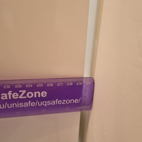

Hi, how can I fill this 1cm gap between the wall and the laundry unit ? Something that I can easily remove in a few months.
Thank you for your suggestions.
Hi @Karellu,
Typically, you would notch the base of the cabinet to fit neatly around the tiles. However, if you are looking for a short-term solution to cover the gap, you could install a plastic moulding over it. Apply double-sided tape to the inside of the angle and then attach it to the side of the cabinet, with the other angle behind the cabinet and against the wall.
Thank you Mitchell, I will try that !
