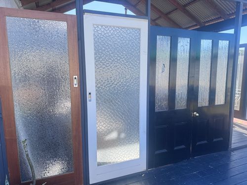

I’ve been on a bit of a door bonanza as I can’t resist good old carpentry and taking on a new, potentially ridiculous project. I seriously need to self elect to ban myself from Facebook Marketplace like some people do with the bottle shop or betting apps. I have attached some photos and a video but I am the world’s worst at photography. And don’t be concerned about the myriad Corona boxes they are exception for solo furniture moving. Sometme

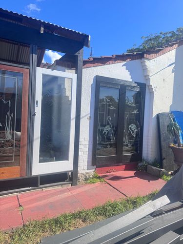

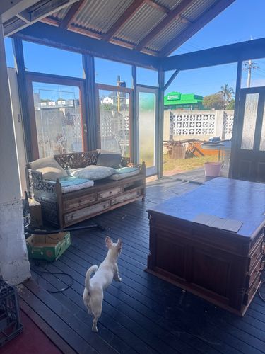

I’m currently in the process of filling in the main part of my front deck using repurposed, art deco doors that I have been hoarding. Essentially a 4 seasons room. They were all originally rolling, internal French doors, probably to the lounge room. Not the black double doors which will be the entry point. I will be making sure I come up with a plan to protect them from the UV once I have all the fixing done. But if anyone has any suggestions, I’d love to hear.
All of the doors are static / fixed other than the black double entrance doors which I have not yet finished framing out the jamb (yes, kind of doing things backwards). They have parliament hinges which is fantastic so they will fold all the way back and we can still have that inside outside living feel. Still quite a bit of work to go and infilling the top and bottom gaps. There will still be plenty of light so I’d love some suggestions as to what to use. The bottom infill is
As much as louvers would be great for ventilation, I am very much on a budget and it may look too busy (says me who has already gone there). Bear in mind that my house will not always be here as it will eventually be developed as it is rated mixed commercial. So I don’t mind things not being Architectural Digest. Plus I am not concerned on everything being perfect because this good old house would be a rabbit hole. Also I am trying to use up material that I already have.
So, please:-

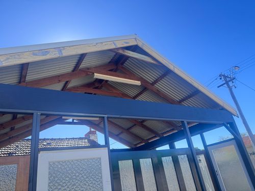

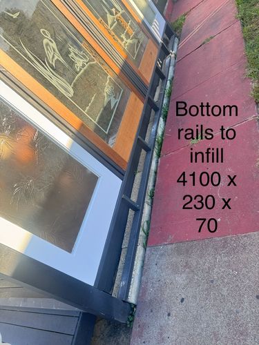

- Suggestions for infill top and bottom. I have blue board, hardiflex and marine grade plywood out the back that I could use up. Unless the consensus it will look hideous.
- Bottom I can probably use just one long strip (realistically 2) as I only need to cover (as per photo) 230 (with a slight graduation to be level) x 4310 x 70 (that’s if I in fill both sides)

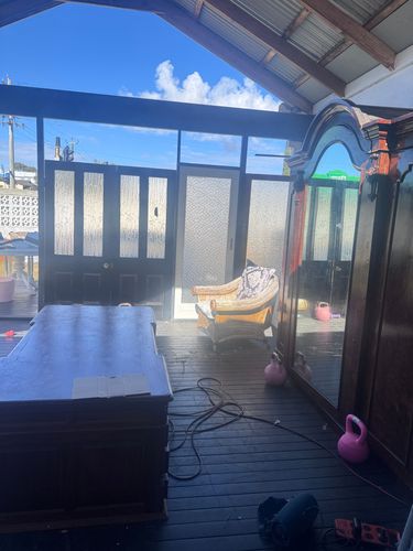

- Top section. I have not properly framed it out yet, but as you can see the doors are matching pairs on each sides but doors have different heights. Suggestions to enclose? There is two more doors to go in where I am currently using as an opening.
- Both Gables. I was thinking of putting a glass door horizontally for light and then framing around with whatever material is suggested.

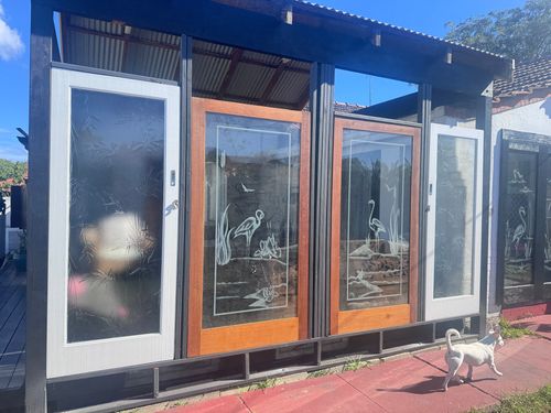

One more piece of advise please - Tint Options for large flamingos in centre
- Alternatives to window tint / vinyl for privacy of glass doors. I have seen some on the Bunnings website, but am pretty certain I would be terrible at applying it. I was never any good at contacting my books for school and I am hopeless with glad wrap STILL!
- With UV protection.
- One way vision. From what I have read, they are not true day and night one way vision when lights are on. I am glad I didn’t learn this the hard way!Also want to highlight the etched glass from the outside.
- Would want to do the 2 large flamingos on deck. Would they be suitable for the frosted glass spray? That will highlight the flamingos and provide a bit more privacy and protection. Duluxe and Rustoleum make aerosol cans. Doesn’t specify coverage. I am also hopeless with spray cans. But do lots of spraying with my Wagners. Or can I use a paint suitable for glass that is a block colour?

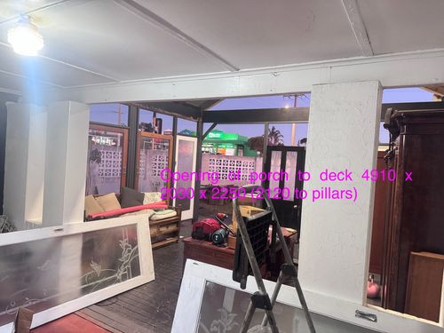

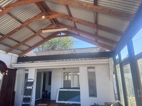

Rough opening dimensions
4910 x 2030 x 2250 (doesn’t account for the moulding that will have to come off) 2110 to bottom of lintel and top of columns.
See my very fancy plans for other dimensions and to give perspective of scale.

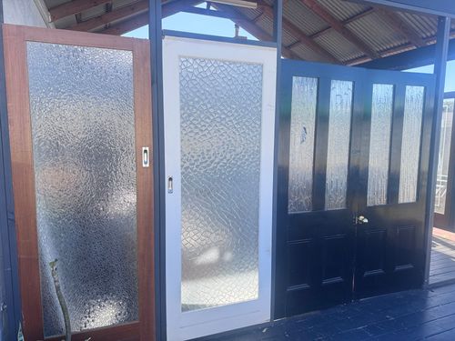

Doors
- Each door is 860 w x 2030 x 35 (total span 2580). 860 is unusually wide for the old school sliding doors. But that is good for my project & the thickness of the glass seems to be 4-5mm so to code. Either way it would be pretty unlucky to walk through the butterflies and etching. So the opening is 2030 which means the doors are too wide by 150 and I don’t fancy cutting them down, although there is plenty of solid timber (100mm on each side) if I did choose to do that.
- There is no locking mechanism, as they were internal doors originally. I am not going to key lock is as main entrance to deck will be key locked, but do want some kind of fix at bottom to stop movement and reduce debris. Even though will be well protected from elements. What are the options? Doesn’t need to be for security. Padbolts drilling into the concrete top and bottom? Won’t be a continuous use as will remain open when not using it as a work space.
- Were top hung as were all old roller French doors, rolling hardware has been removed.
The I need help plan
Where I really became thoroughly confused as it’s virtually impossible to find specifics such as how thick are the channels, is there a threshold if fixing to bottom, what overlap do I need etc.

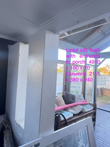

- Originally I was going to hang them flush with the entrance where the current pillars are and use a pelmet, but then I would have to frame the whole lot out to make it a functional room, won’t I?
- Rough opening is 2030 and doors are total width of 2580 (+150mm). I REALLY don’t want to cut them down, but mounting to the lintel is the only way I can see possible without me having to make a frame on the outside.
- I’ve read conflicting info about what dimensions the rough opening needs to be in relation to the door width but I am really hoping I can mount them to the lintel and fit all the hardware in.
- The Lintel is Lintel - 4910 x 190 (notched to rake) x 70. Therefore not wide enough. Sits flush to the entrance of the columns. So add to lintel immediately behind to seat on column / pillars which are total height 2115 x 380 x 240 (each column has an opening of 1330 x 375 x 240 but if I extend the added lintel secured to the original it will have end bearing so the openings won’t be an issue?)
- Do I have enough room for the brackets as the Lintel is 190 h.?
- What system should I go for? I have Googled so much I actually think I am friends with Google AI. Plus spoken to Cowdroy and Brio, but they both were very vague about technical specifications. I understand of course, this is not a standard project.
- I am thinking having an overlap of minimum 50 of each door. Will this then fit? It is bang on 2030.
- I image I will have to get something custom built unless Bunnings has an adjustable kit or something I could cut down? I spoke to Cowdroy this morning and the guy semi indicated that I could cut something down. His words “hack a bit off”.
