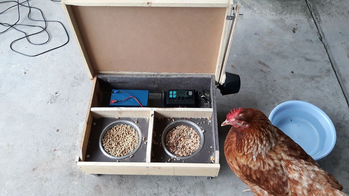

The servo actuator is mounted on the right back corner of the box. I measured up and made a base to which the servo actuator is bolted. The bracket will secure the assembly to the back corner.
We also need to make a plywood extension arm that does the actual lifting to raise the feeder cover.
Checking that the servo actuator opens and closes the feeder cover. Note the connection between the arm and the feeder cover - there is no direct connection! - I used two brackets to mitigate jamming. I also fitted a plywood cover.
Step 3
Dividing the box into three compartments, the front half is for the two feed bowls and the back for standalone battery or battery with solar controller.
The standalone battery needs a power adaptor cable with spade connectors.
For the solar option the bare ends of the battery adaptor cable are connected to the controller.
Step 4
With the servo actuator and battery connected to the controller we are checking everything is working - all OK.
