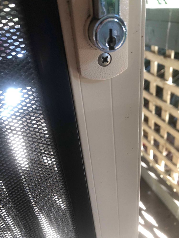

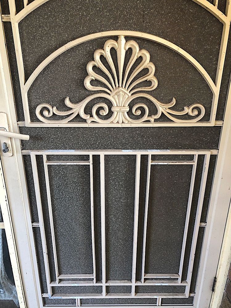

Hi Guys, I'd like if possible to take the security mesh from the front door frame to clean up, and I'm stumped as to how this comes apart, there's no piping as far as I can see.
Hoping I can get help with this.

I'm sharing the sentiment here that you would want to try to avoid removing the mesh and explore every other option first. Please let us know what your goals are - we'd be happy to help.
It's essentially a "Crimsafe" style steel security mesh fixed to that outer same colour frame. This is then press-fitted by a machine in the factory and is not something you can remove. Tomorrow I am restoring a similar mesh that has surface corrosion on a sliding crimsafe style door. Basically, I'll be cleaning the corrosion off, masking the frame inside and out and respraying the mesh both sides. Fortunately it doesn't have the complication of internal framing like your door probably has.
What needs cleaning up, the mesh or the frame? And is it debris buildup or scratches to be repaired? If you can send through a few supporting photos with your reply will help advise.

Mmmm An interesting question, I am thinking along the same lines as @EricL as in that edge piece is protecting/holding the mesh in place. It may be crimped in place as its a security door grill (we have all seen those adds 🙂 )

I suspect that the brown metal strip in front is acting like a push in cover that is hiding the screw set that holds the mesh in place. I propose using a flat head screwdriver and see if you can lift the brown aluminium piece off the door. Please note that this is just an educated guess, if it puts up too much resistance please stop and do not force the cover off as it might damage your security door.
