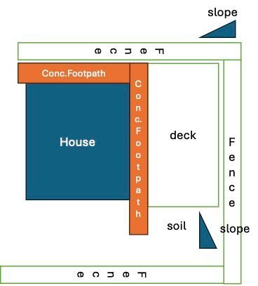

I installed a low-level deck (timber frame with composite top) under the clothesline, which is located next to the colorbond fence. For the installation of the timber frame, I removed some dirt so the ground under the deck is lower than around the deck. When it rains, I noticed that water was not draining well, and a puddle was created under the deck. I'd like to get some advice on how to drain water effectively. Thanks.
