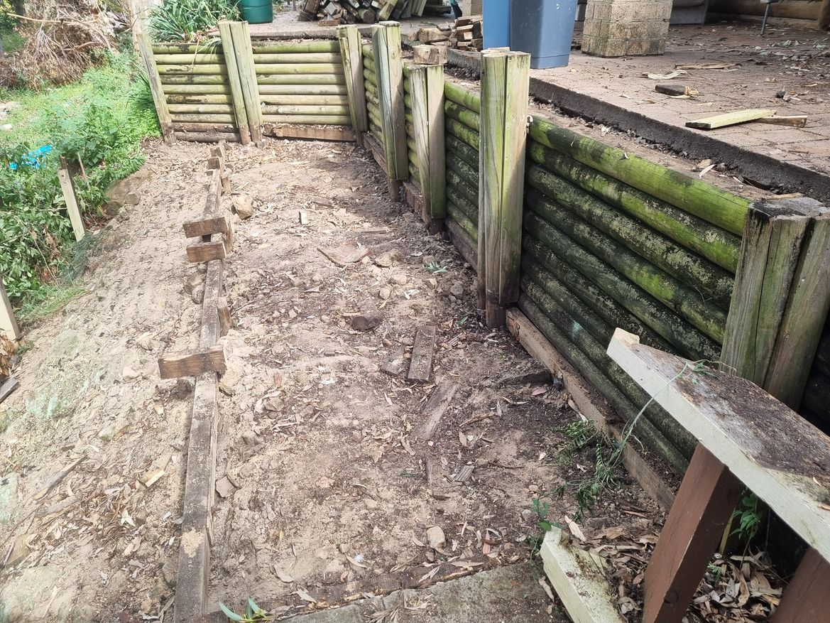

I have a 1m high log retaining wall. The cost of having a professional to rebuild is prohibitive.

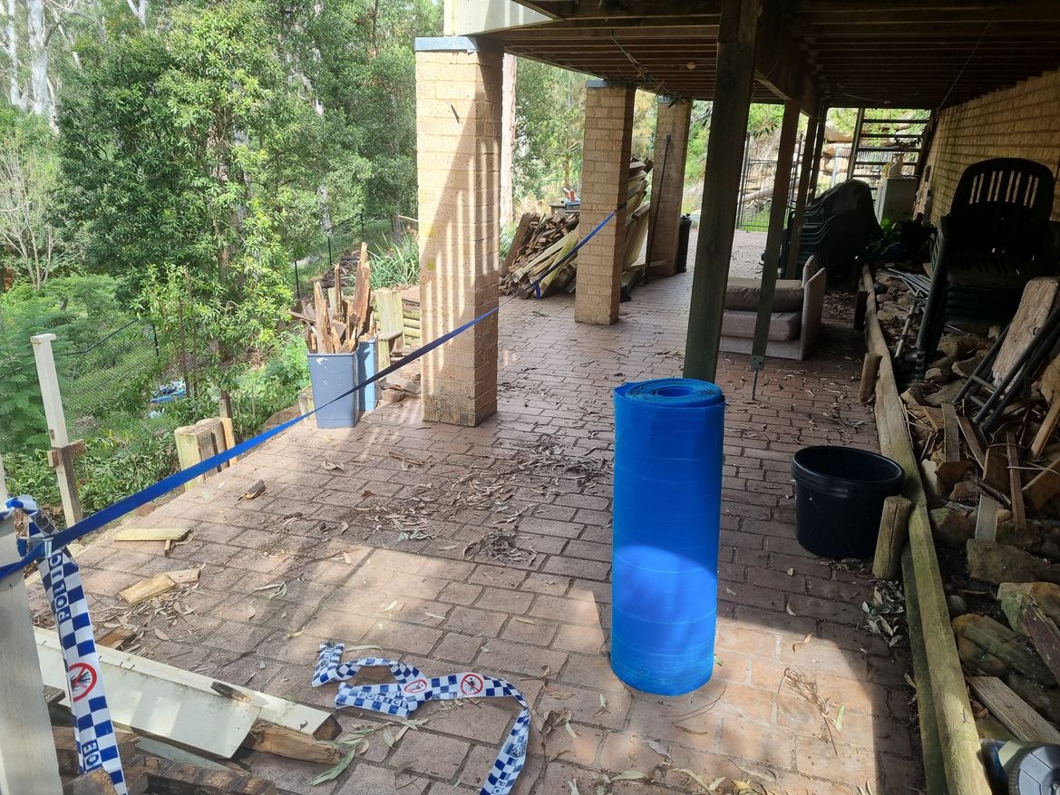

I can't rebuild the wall, even in sections, as the risk of having the ground behind collapse is untenable. There is a large concrete patio topping the wall, the house is on piers, but I really don't want to disturb this ground at all. The timbers of the wall are actually in good condition.
Underneath the large concrete patio there is a significant void between concrete and level of dirt - it has dropped fairly uniformly by around 15cm ave. Once I have repaired the retaining wall, I am having closed cell foam treatment by a professional to fill, lift and stabilise the void.

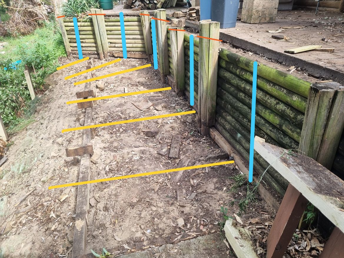

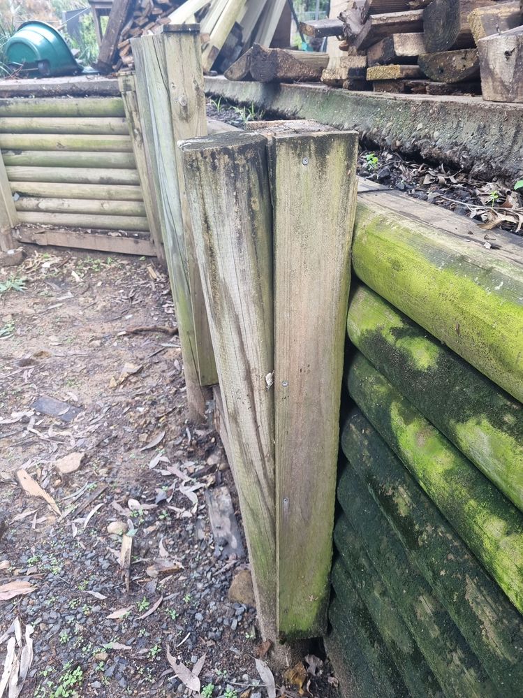

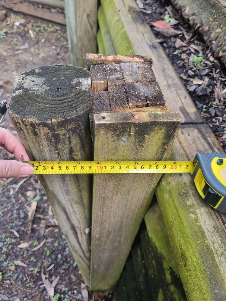

I'd love your advice guys - you always understand where I'm coming from and have offered excellent guidance. As the wall is 30yrs old, and had some 'interesting' supports added by the ex around 20yrs ago, it doesn't seem to be moving. I'm pretty sure the timber uprights he put in weren't deep enough and he attempted to rectify the lean after 10yrs by adding posts and sort of wedging-in the back of the post. The ground is awful, dirt, sandstone boulders/rocks. The wall is mostly vertical, just everso 'slightly' leaning in areas. So I'm thinking it's better to leave existing wall undisturbed, but stabilise with steel H posts, 1 m deep in ground. If you look at image 2, I've marked where I plan to add the H posts (in blue) and where I'll trim the top of the posts (in orange).
1. Where there is a slight lean, if I put an H post in vertically, there will be a gap between posts and the wall at the bottom. What should I do to stabilise at these points?
2. I'm also sure the drainage is inadaquate behind the wall (I remember some ag pipe going in). Because there's the concrete patio topping the wall, I don't have access to dig out behind it and add drainage/geotextile fabric. I'm thinking perhaps seeing if I could get some vertical drains in where I can from the top, or/and digging under the base log of wall and placing ag drains running out? (see yellow markings).

Blue = H posts Yellow = position of ag spot drains under wallOrange - trim tops
Retaining wall...zoom in on interesting repairs!
Patio above wall (to left)
