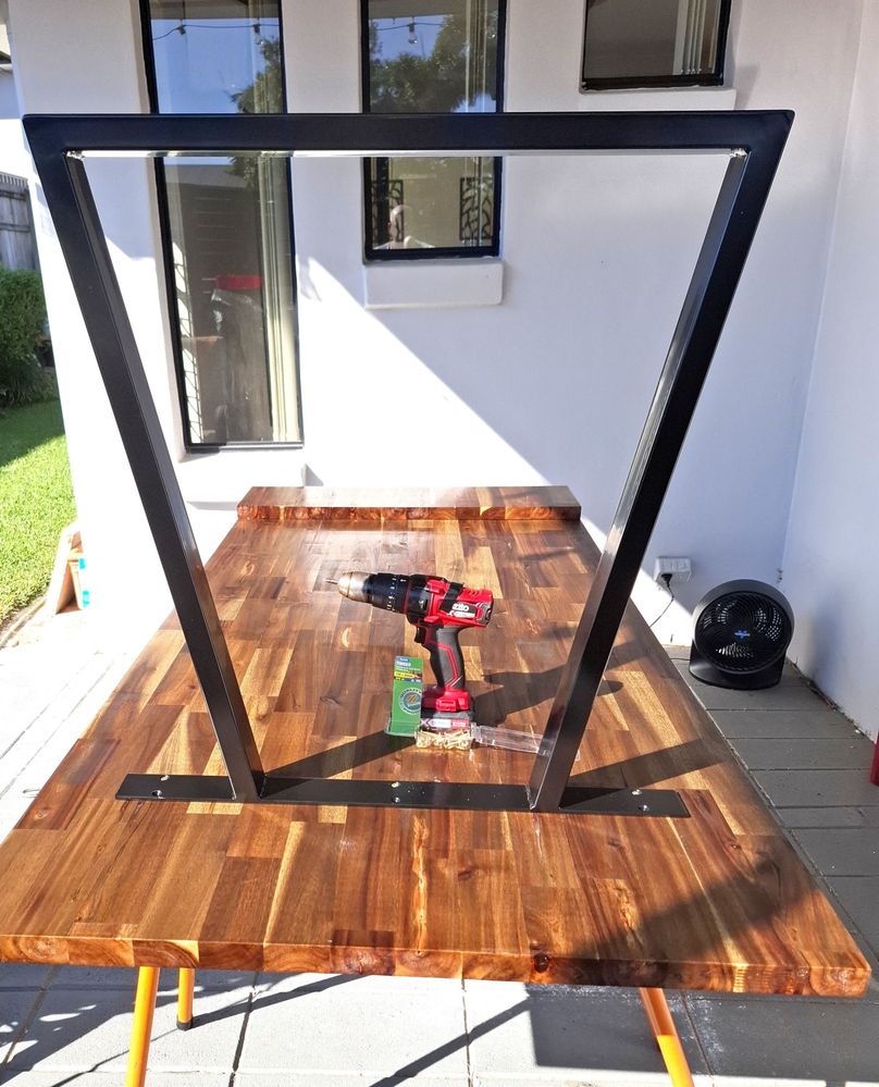

Step 1

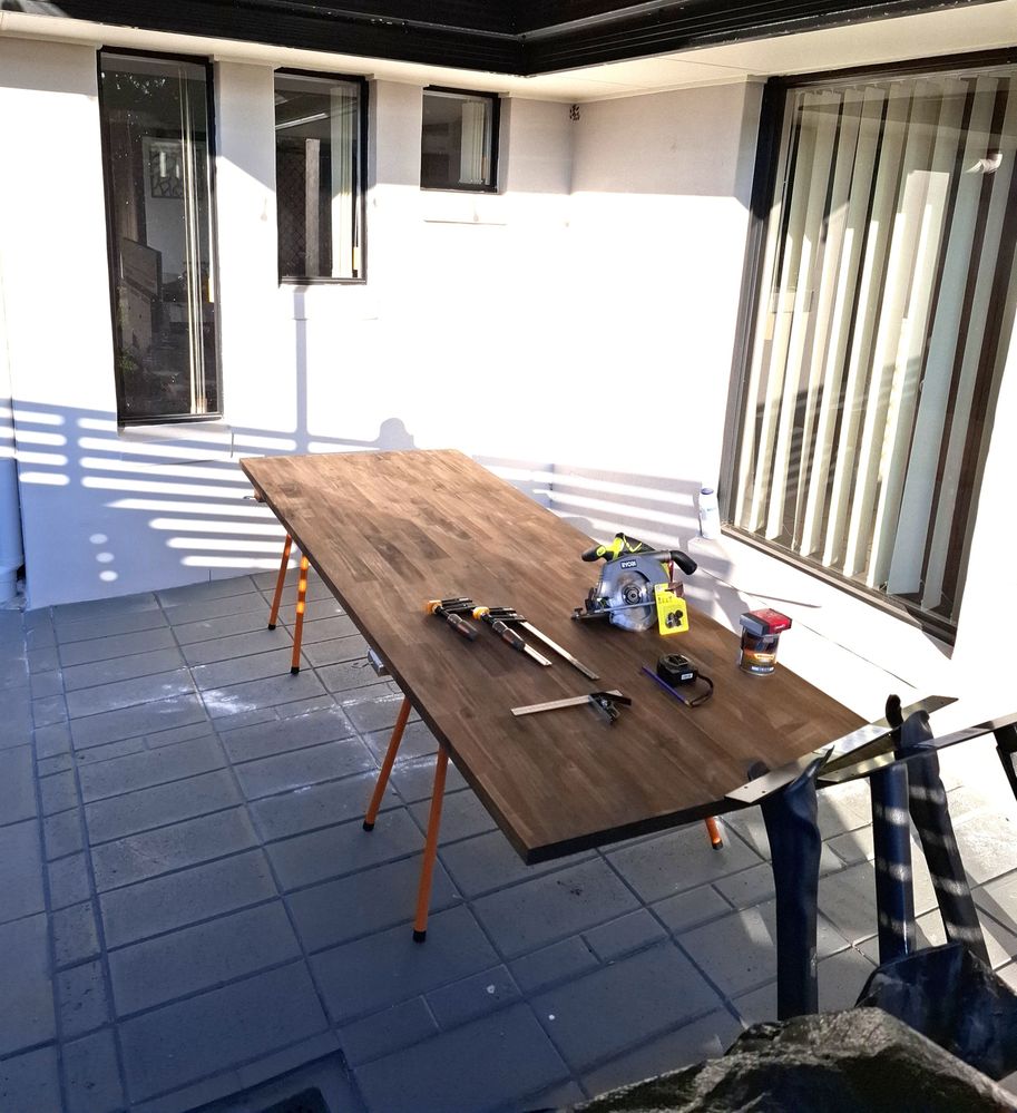

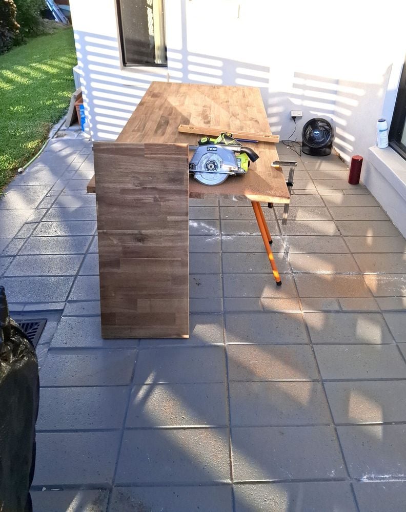

Set up your work horses evenly spaced apart then place your board on top leaving enough material at 1 end to remove a 400mm length.
Step 2
After measuring and drawing a straight line 400mm from 1 end, take your circular saw and cut along that line. This will become your floating mini condiment table.
Step 3
Sand all sides then apply a coat of varnish.
Sand all sides once again and apply a second coat of varnish.
Repeat until you are happy with the finish.
*The sun will show up areas of uneven coverage.

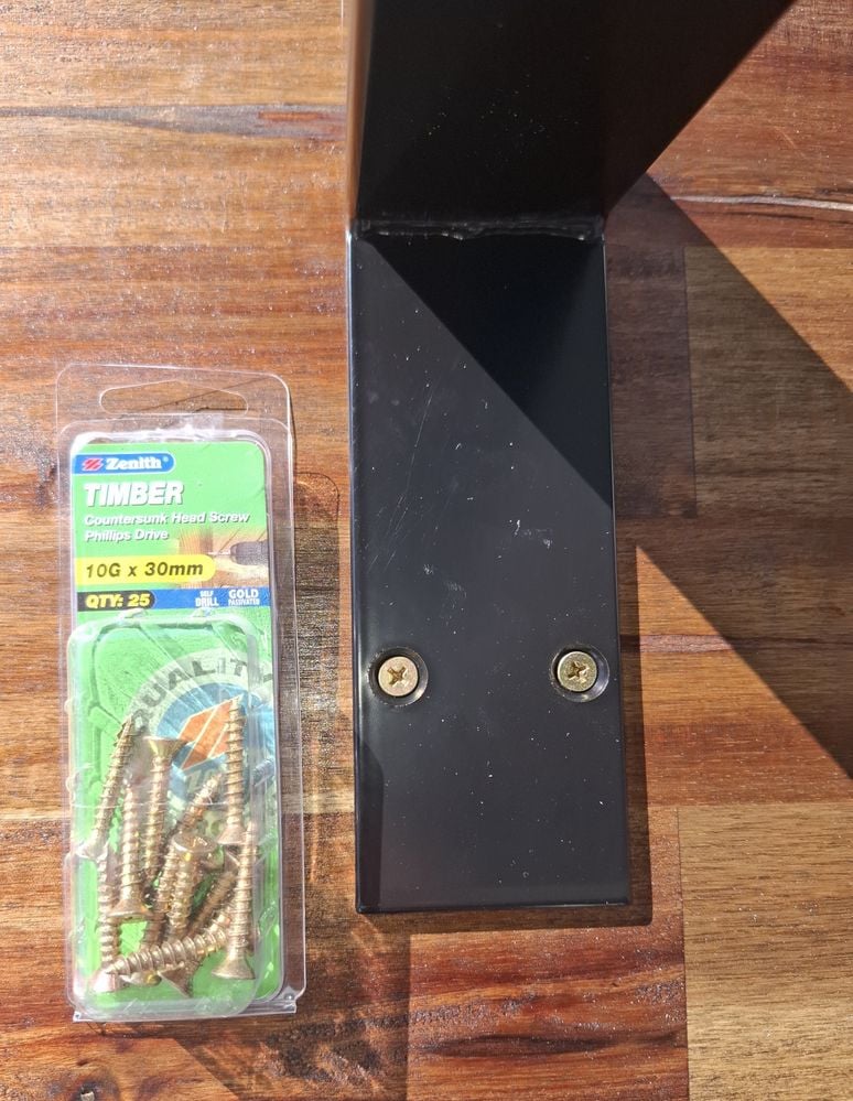

Step 4

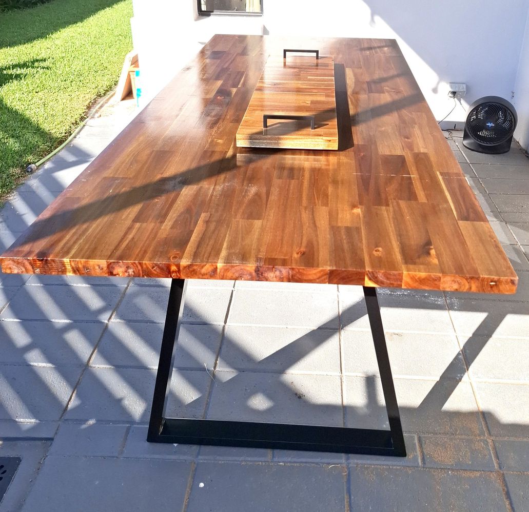

After the varnish has dried well, place the underside of your table upwards on the workhorses and attach the legs using your Philips head drill and 10Gx35mm screws. No need to pre-drill holes.

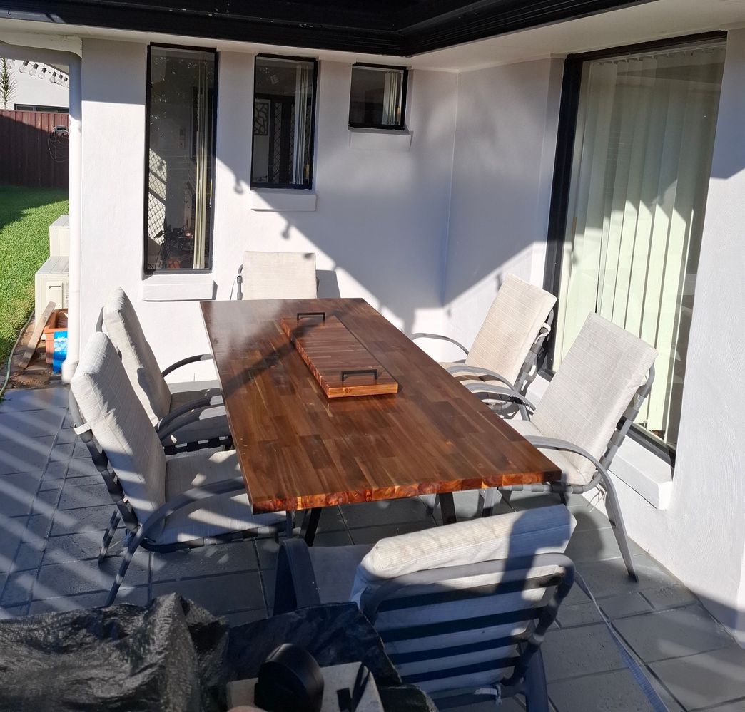

Step 5

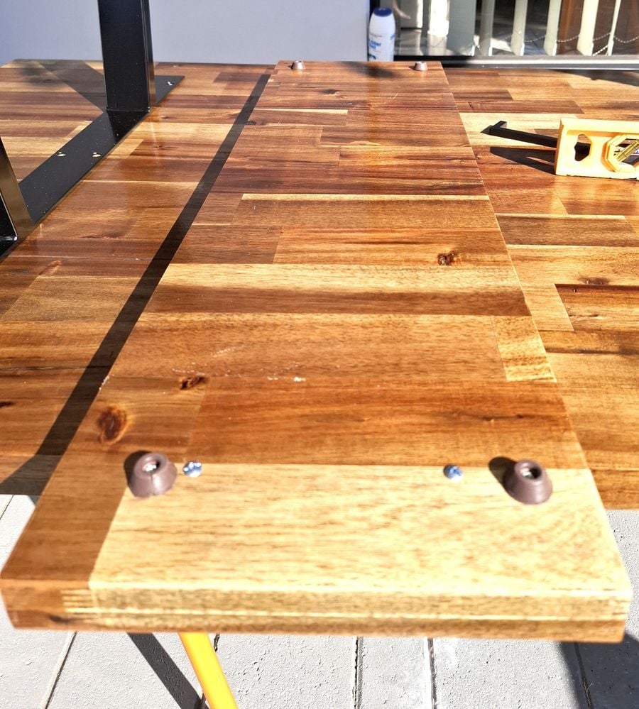

Now simply attach your clear rubber bump stops (feet) to the underside of your Floating Mini Condiments table using the screws supplied with them.
Step 6

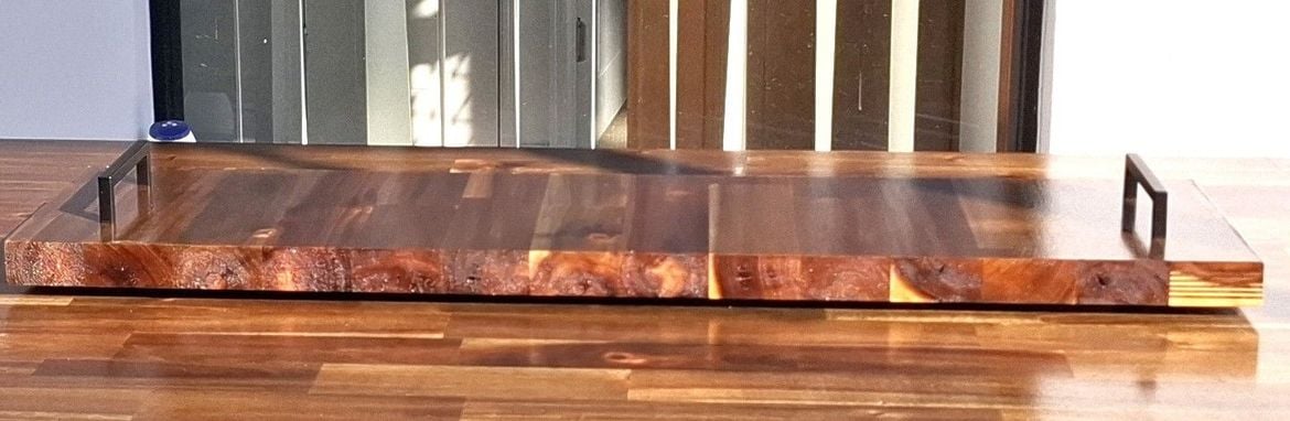

Now flip your Floating Condiments table over and position your handles at each end. Using your 4mm drill bit drill holes and secure your handles with the Philips headed bolts provided with the handles.
Step 7

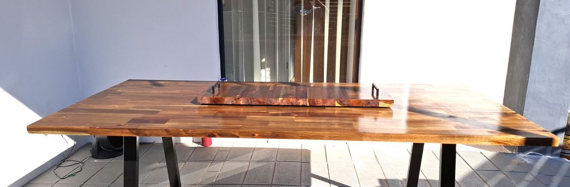

Now just position your new BBQ 6 seater table with Floating Condiments table on top in the perfect position.
Crack yourself a cold beer and stand like a triumphant Caveman that has just discovered fire and beat your chest proudly! You are done.
