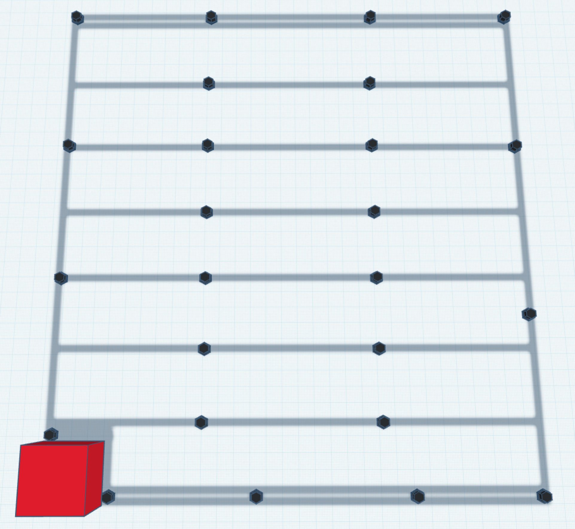

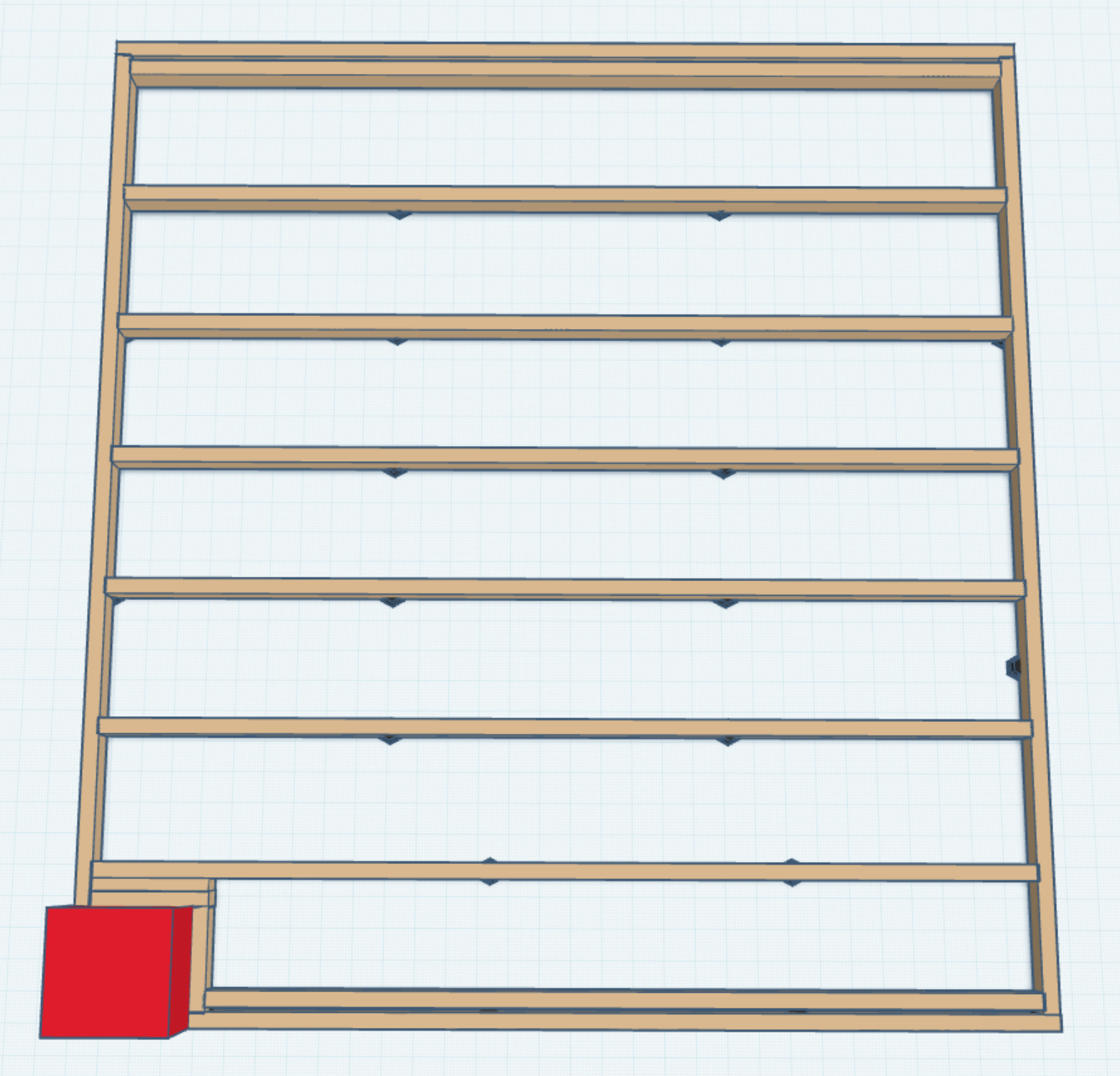

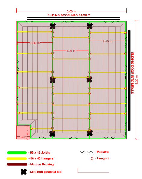

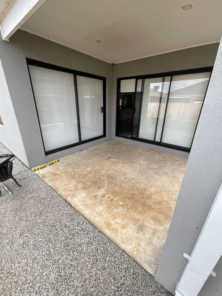

I need your assistance with the promise I made to my mrs to do Alfresco decking for us. I am currently in designing phase, watching plenty of videos. I am handy with day to day home repairing stuff using a drill, screwing, unscrewing things, attaching, detaching, fixing things. This will be my first big project and I have created a plan a detailed drawing for my vision based off the videos I have watched and learnt. I have questions that I will document below step by step. What I am requesting is a legend who knows things inside out, can hold my finger for a bit digitally while I am able to fly on my own.

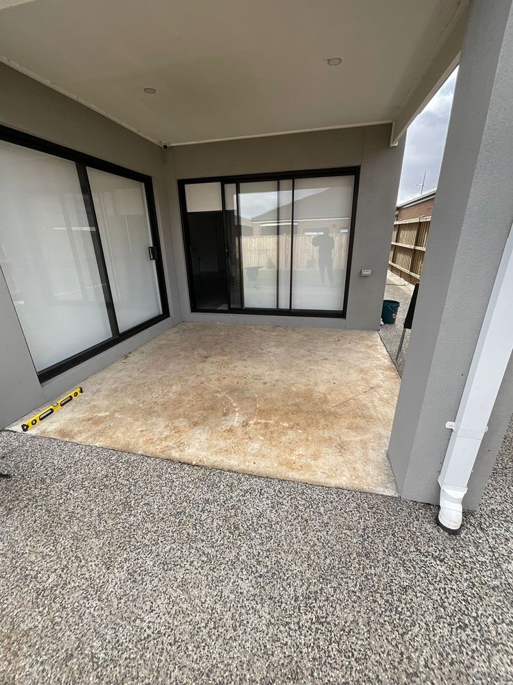

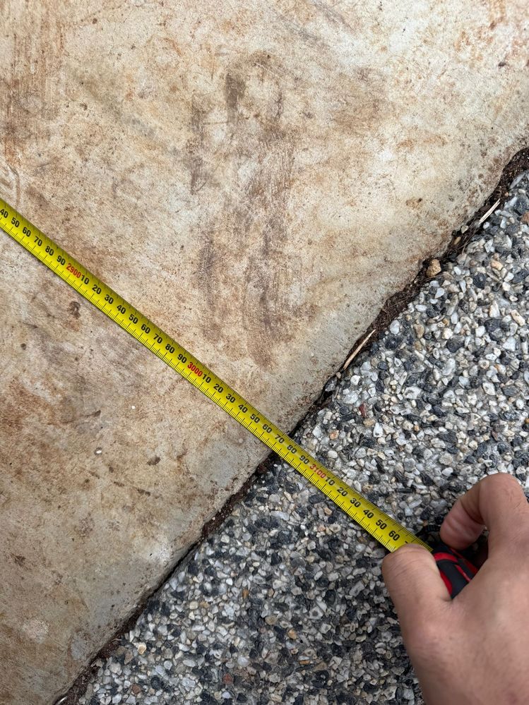

Alfresco dimension - 3010mm x 3330mm
Step 1 - I have confirmed alfresco slab is all level using a spirit level.
Step 2 - Measure and cut 90 x 45 timber running top to bottom in photo and permiter. I want to avoid attached anything to the house toward family and meals as house is rendered hebel. 375 x 375 hebel pier is marked in red as well.

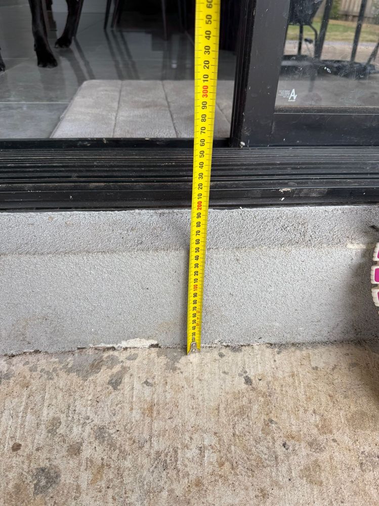

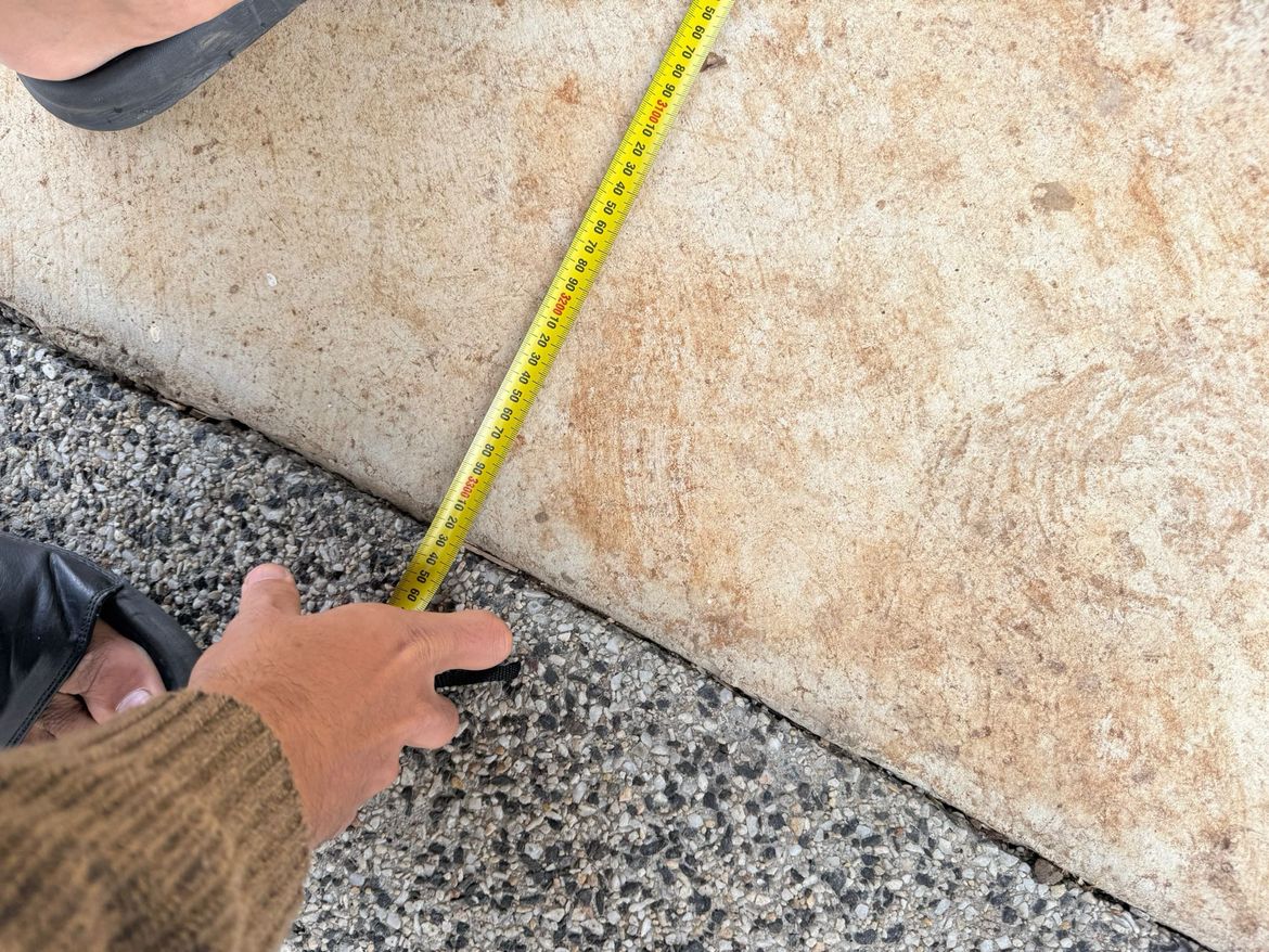

Step 3 - Total height from slab to door sill (if thats what its called) is 155mm. That means for decking to be almost level, I will have mini foot height 40mm + 90mm timber + 20mm boards.
Step 4 - Install horizontal joists roughly 450-500mm spacing by drilling and screwing and additionally using joist hangers.
Step 5 - Start with perimeter / picture frame on 3 sides and then work outwards.
Questions:
1. Is there anything wrong with the above understanding? Surely there is but I dont know what. All advise welcome humbly.
2. Tools needed: Circular saw, impact drill, driver drill, rotary hammer drill,
3. Are the vertical joists spaced 1m apart enough for 3010mm span?

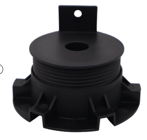

4. Are 3 mini feet under 90 x 45 enough for structural support?
5. What screws to use to secure mini feet to the slab firmly?
6. What screws to use to attach 90 x 45 to mini feet? Should it go all the way through timber. Would you screw it or bolt it?
7. What screws to use to attached horizontal joists beween 4 x verticle joists? I do understand they should be minimum 90mm so it goes through the verticle joist and atleast halfway through horizontal joists.
8. What nails to use to further strengthen horizontal joints connection with verticle joints using joist hangers?
9. What's the best way to secure the permiter 90 x 45's (all 4 external sides) to the verticle joists?
10. Can 40mm packers be used under 90 x 45's externally as mini foot will be visible and wont give a finished look? Sorry if terminology is too incorrect.

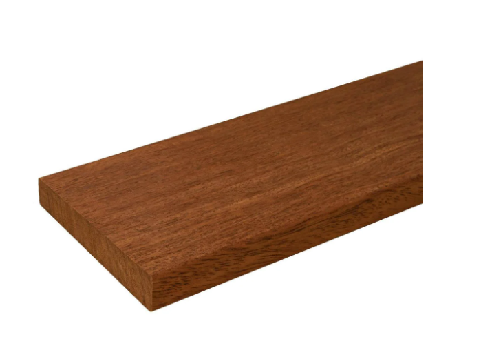

11. What screws to use to fasten decking boards to the horizontal joints?
12. Do you recomment 140mm or 90mm merbau decking board given the area?
13. Can the merbau timber decking bioard be stained in Charcoal colour after whole deck is installed? to match some of the interiors.

Mini feet pedestal

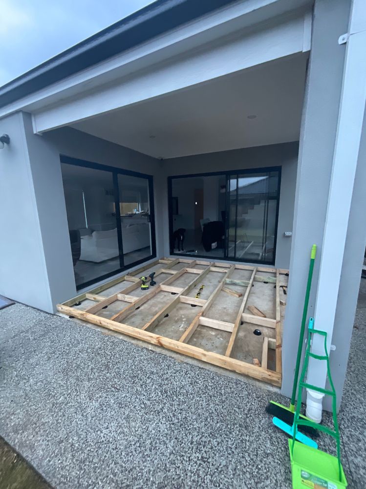

I have attached photos of all products i am going to have to order. Please help if i am missing something. I dont know anything about what screws, bolts and nails to use which is asked in the questions above. Also, please advise if there's any question that i should have asked but haven't.
