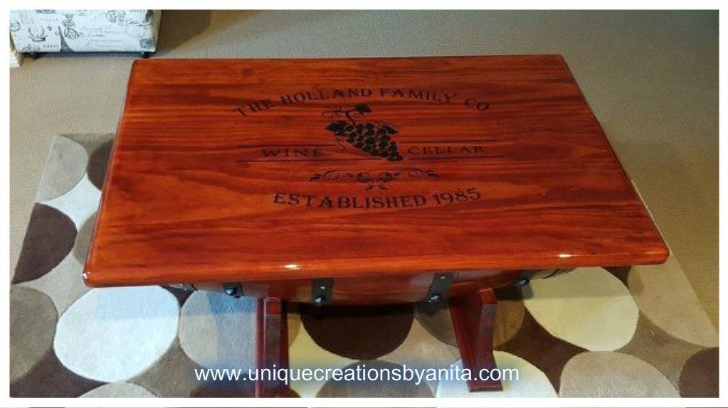

My tabletop was a bit of a cheat because I am a big fan of building from recycled furniture, I used a broken coffee table and recycled the top. I sanded all the imperfections away and did my final sand using 320 git sandpaper. Then I attached it to the base using my 4 x 9 cm brass hinges. I stained the top and applied a coat of varnish to seal the stain in. (On my first test run the stain ate into my decal and destroyed it) I designed a family logo using Microsoft word ( lot's of company's on the internet will do this if you supply a picture). I went for a winery logo in keeping with the wine barrel theme, my family name, the year of my marriage to make it more meaningful to me. I ordered a vinyl decal online, but it is very important that the decal has no border or background or this will spoil the end result.
I transferred my vinyl decal onto the table, do this slowly so you do not crease the decal, the final result must be smooth. Now the most important step. You must work in a dust-free environment. I put up a tent and kept vacuuming it out and left it to settle for a few days. I put a strip of masking tape under the top of the table so that when the liquid glass runs over the drips will attach to the tape which can be pulled off to keep the underneath clean. The top must be wiped with a tack cloth very well before you pour the liquid glass over the tabletop. There are many videos on youtube that give you instructions on how to pour the Norton liquid glass.

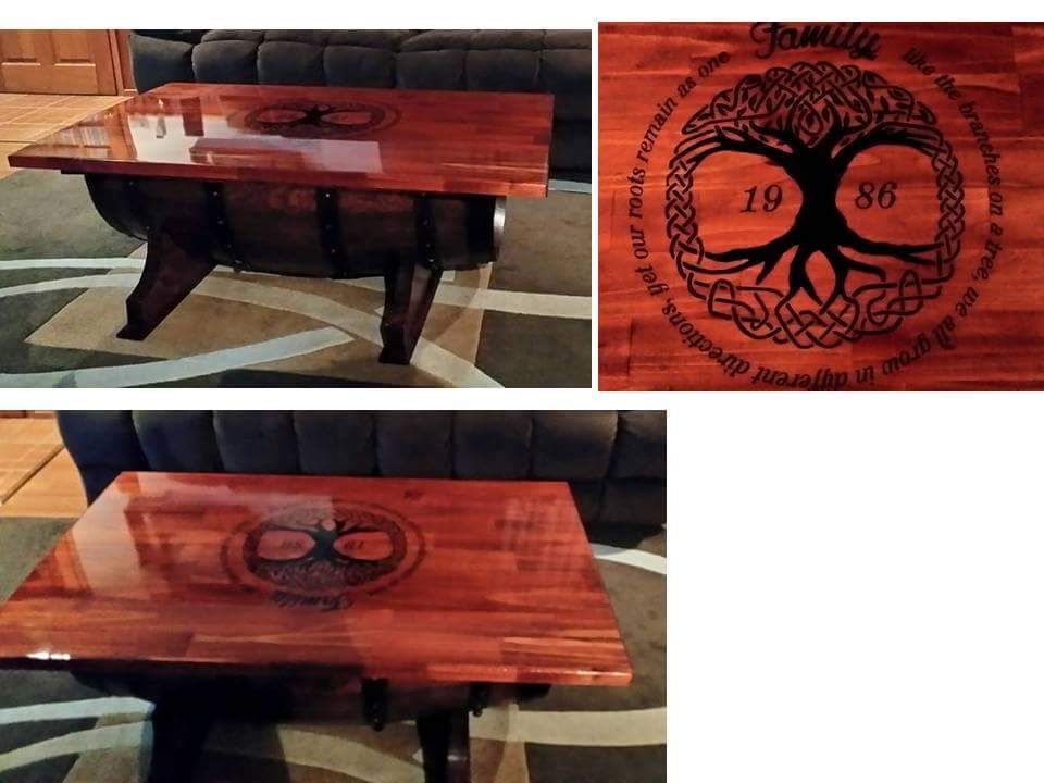

This was one I made for my sister as a gift.
