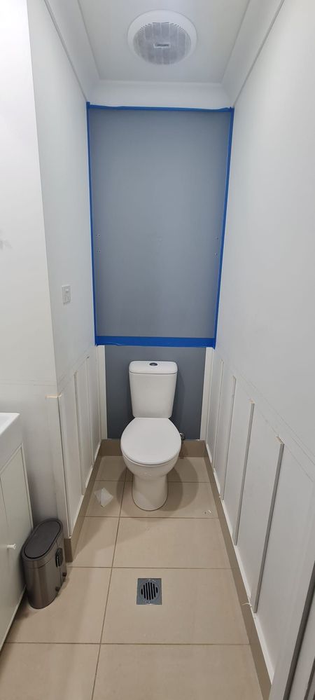

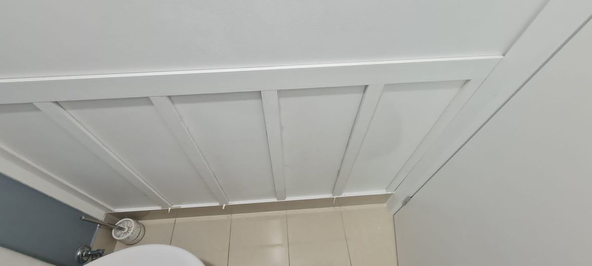

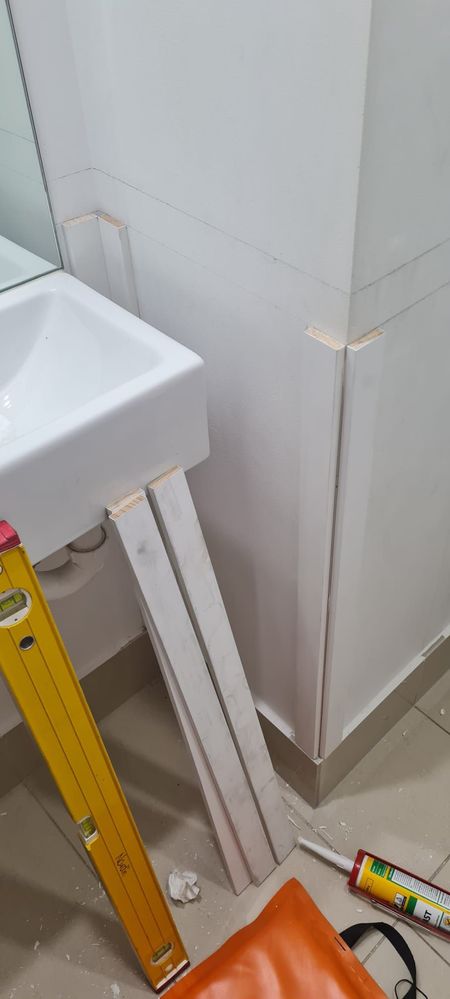

We cut to size the pine. We measured at 750 high for the horizontal to sit on top of the tiles. For these we used 31x11mm Pine Dar with spacing of 270mm all around.

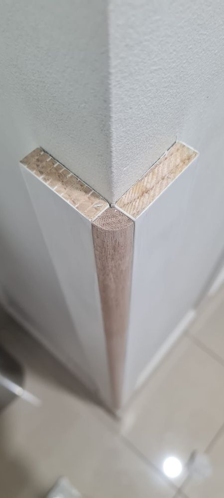

The Quad 12x12mm used on the outer corner of the wall to give it a round and smooth edge.
Then we cut the 66x11mm to go all around the top horizontal.

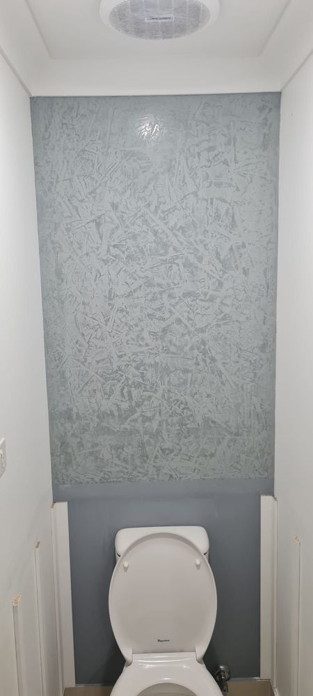

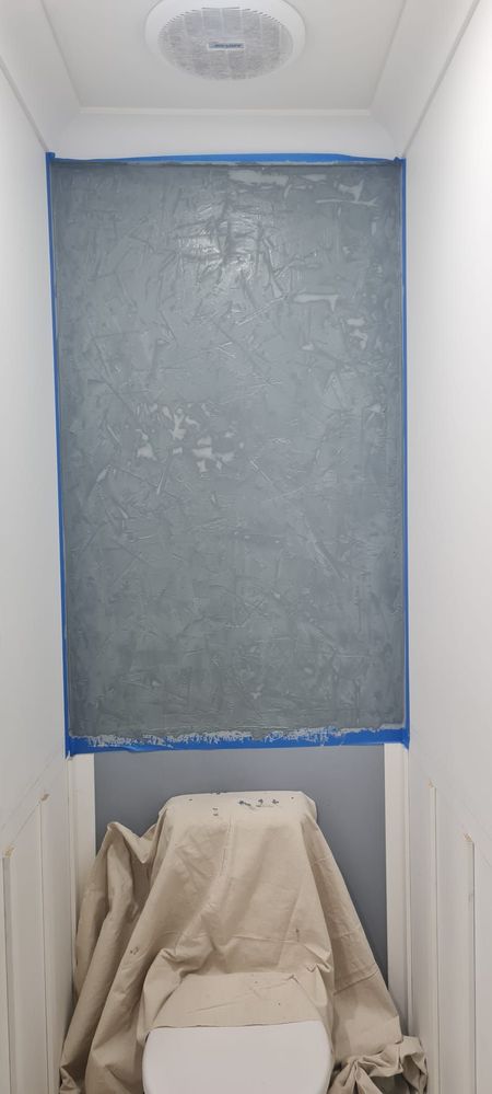

We filled, sanded and painted the pine.
We created a feature wall as the bathroom is very small.
We used the Dulux Concrete Effect.

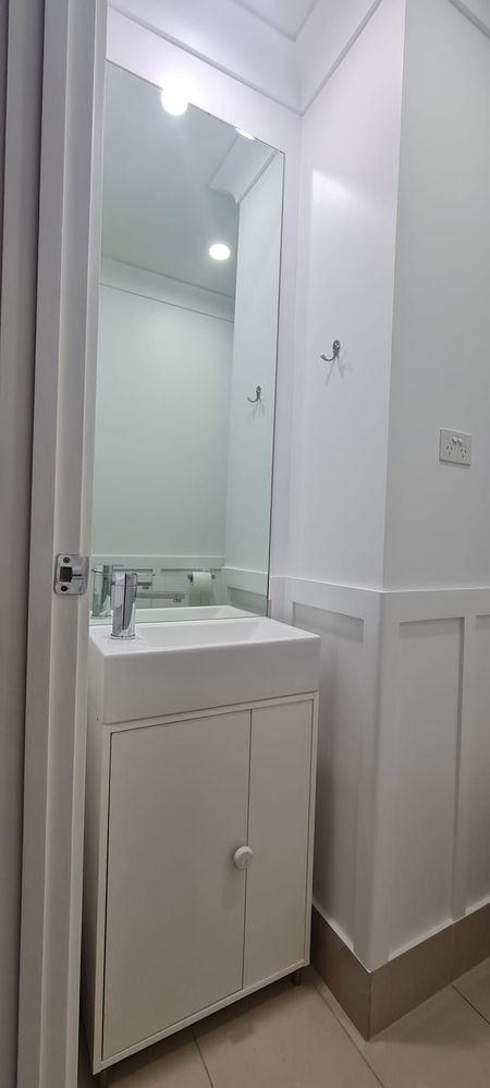

Step 3

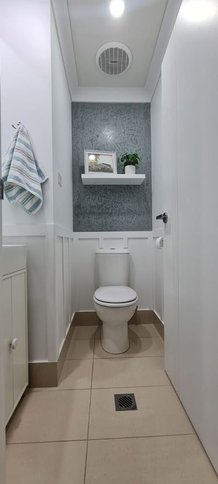

Painted the rest of the walls and pine in Dulux White. Added a floating white shelf 600x38x235mm.
Finished with accessories and after 4 days the guest WC was finished.
