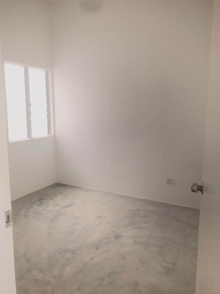

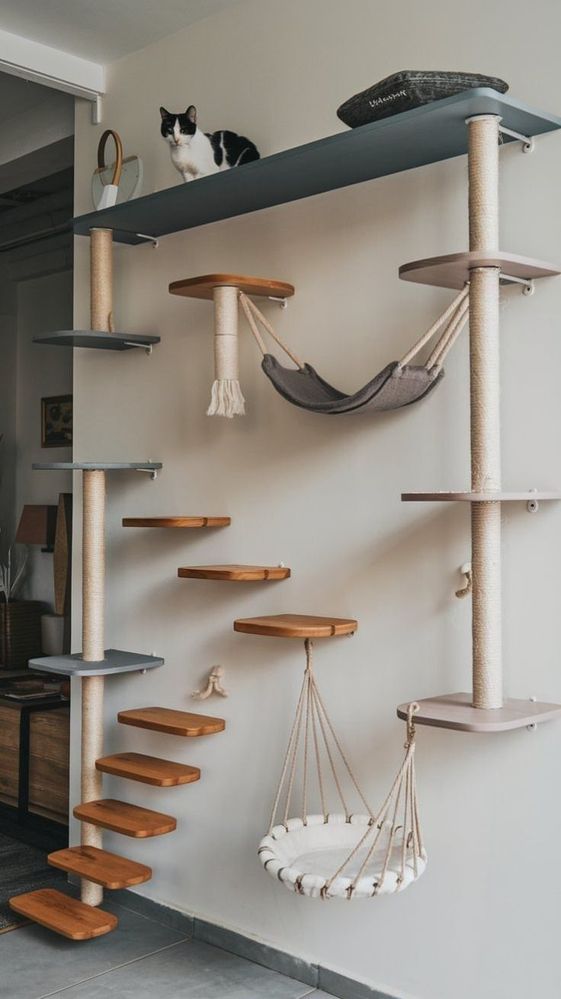

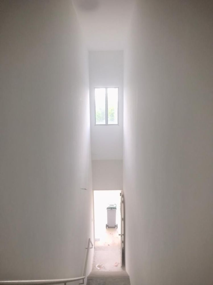

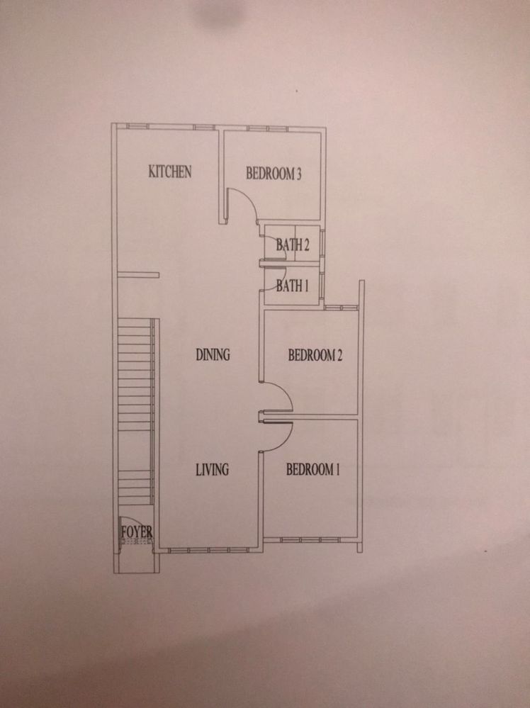

Hi, I just got a townhouse and on the upper floor. I have 17 cats with who are like my children so i would like to provide the most comfort and stress free life from them but also to ensure they dont fight so my neighbors would not find out how many I have. I have attached the room I will be building the enclosures in. My plan is to have 17 small sized wooden enclosures mounted on the wall so each one of them will have their own space. I cant let them out in the living room which is connected to the kitchen because they have habits of scratching things and unhygienic(the kitchen where i cook). I actually lost my husband recently who was the one planning their entire room and their playing area. With him gone, i have to rely on outside help which is carpenter and i need to provide a concrete concept and plan so they can get started right away. I also plan to use the staircase area which is attached together with the house(some townhouse have the stairs outside but mine is inside with thick walls). Attached is the room and staircase area. If any of you have ideas or concept that goes with the space I would be very glad for ur help. I also will attach the designs i found online and hope to get advice on whether my plan is feasible. PS: The enclosures will be in the room while the playing area will be in the staircase.

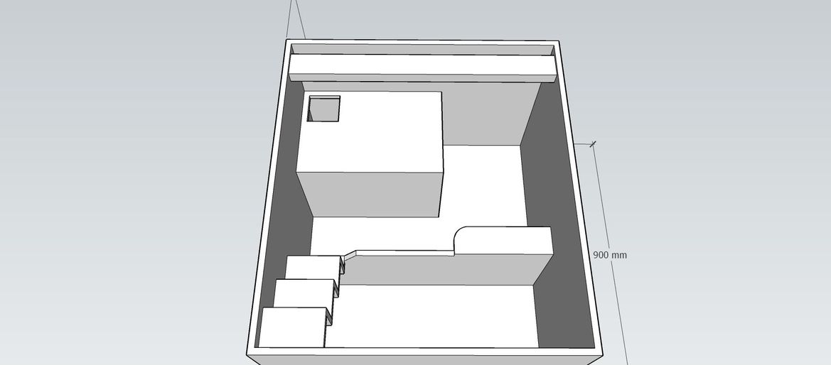

Please allow me some time to draw up a sample sketch of the enclosures and play area. As soon as I've finished, I'll post the drawings here.
Hi Eric, thank you so much for your response and I am looking forward to the sketch. But the enclosures i planned would be 17 in total, which 1 for each of them so they have their own space, feeding station and litter drawer. I want to do this way as I am a freelance photographer and would have to travel on weekends and I need to make sure they all are comfortable in their own space. Thus each enclosure is actually private to each one of them and i will place a name sticker on each one so i remember to put them back in their own enclosure. That means i also need to be able to close and open the enclosure so a plastic or glass door would be best option. I am also attaching the floor plan to help with the sketch. I will be using bedroom 2 which is approximately ard 9x9 feet and staircase(not sure about the size) area for them.

Thank you for the extra information. I'll add those details as I draw up their enclosures.

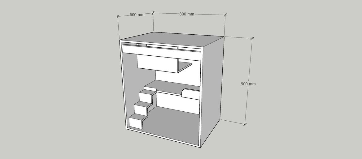

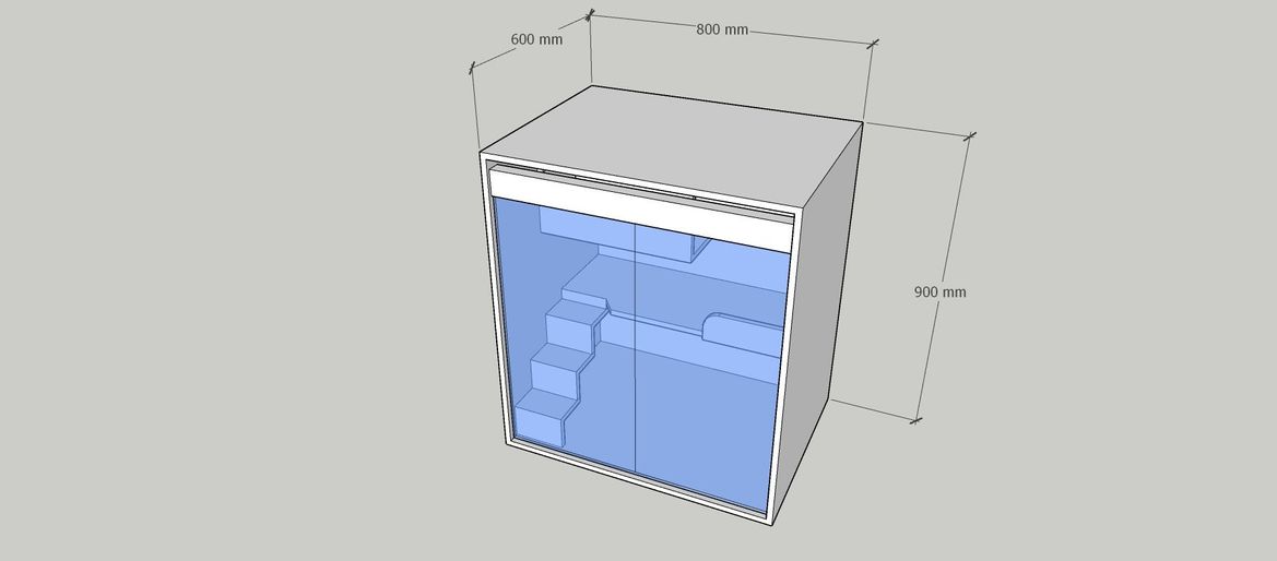

Since you've indicated that the cats will need to be enclosed in their own space. I followed the example in one of your pictures. However, I've adjusted the shelf and size of the living quarters for larger mature cats. The layout of utilities will still be the same, the kitty litter at the bottom and the feeding bowl on shelf, you can include a drinking bottle if you wish.Ventilation will be at the top of the box where I've placed a single timber piece that is just slightly lower than the roof. I propose using Perspex for total safety for both you and the cats. For the enclosure itself, I suggest MDF painted and fully sealed for affordability. Please have a look and tell me what you think.
Wow, this is very useful design for my cats. But some of the material you mentioned I do not know if can get in my country. I will let the carpenter know about it in case he knows of them. I actually changed my mind to make a large floor to ceiling cabinet filled with this enclosures built side by side instead because every carpenter i asked told me its risky to mount individual enclosures on the wall without a solid metal frame. But i can incorporate your design in the the cabinets for them so likely 8x8 enclosures in one cabinet thus 2 cabinets in total that i can place in the room. Rest of the room space can be utilized as their playing space.

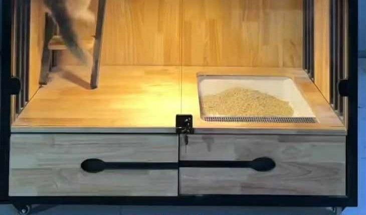

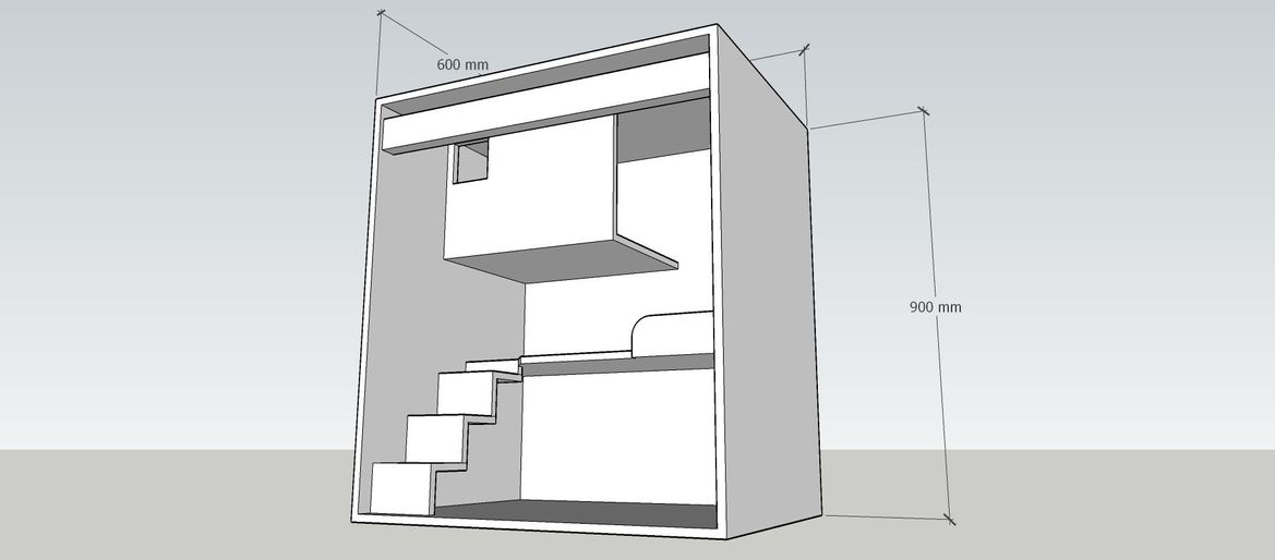

Hi sir, I already hired a carpenter and he informed me that the material will be pine wood. Also I have changed from mounted type enclosures to a large cabinet with 6 enclosures in each which totals to 3 cabinets. I also requested for it to be attached with wheels so i can move them when i need to clean under the cabinet. I completely forgot that I could design cabinet instead of mounted small enclosures due to preconceived notion. I have attached a sample of the cabinet I told the carpenter to make but with some changes within each enclosure according to the design you sent me. I trully appreciate your help in this and the carpenter have not started work yet so if you have additional design ideas or other concepts i would love to hear them. I also ask for drawers to be included in each enclosure for ease of cleaning and emptying out the litter. Maybe you can help me to incorporate that into the design? Again I am grateful for all the suggestions and support from the talented people in this site. I will definitely upload the finished product here soon.
Here is an amended sketch of the cat apartment with the drawer underneath, I'm sure your carpenter can easily incorporate this into the design you have chosen. My best advice is to measure your biggest cat to make sure that they all fit into their apartment.
