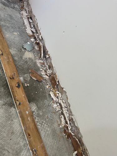

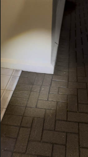

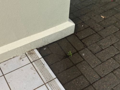

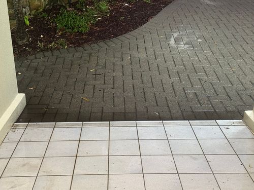

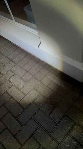

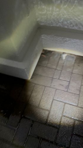

I’ve noticed that surface water pools at the front of my house, next to the wall, during rain. It’s not too serious, but it does cause moisture to accumulate. I noticed this when I removed the skirting board and found mould and damp plaster.
The ask
I’m hoping to understand how I can adjust the level of the pavers, waterproof the wall, and do anything else I should do to prevent water pooling near the wall.
