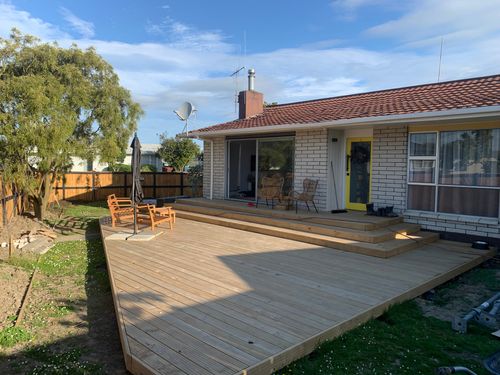

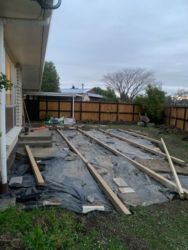

Measure out the area and distance between holes. Dig holes and put in piles, making sure they are straight a level. Fill with concrete and leave to harden - best done when no rain forecast.
Cut and secure bearers to the piles
Step 2

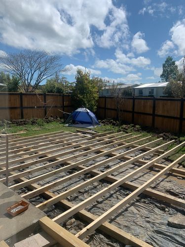

Secure Joists to bearers - 400mm spaces between joists
Step 3

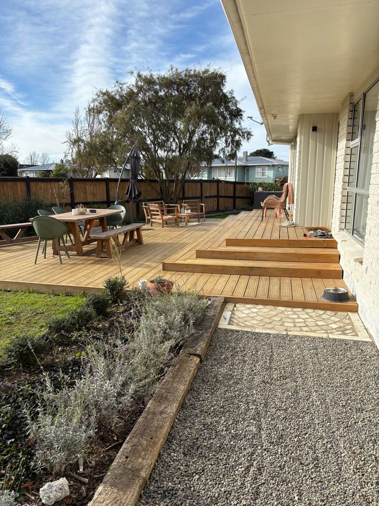

Measure length, depth and height for steps. Build framing for each step and secure to joists.
once all framing for steps is completed, secure decking timber to joists - butt timber ends together.
